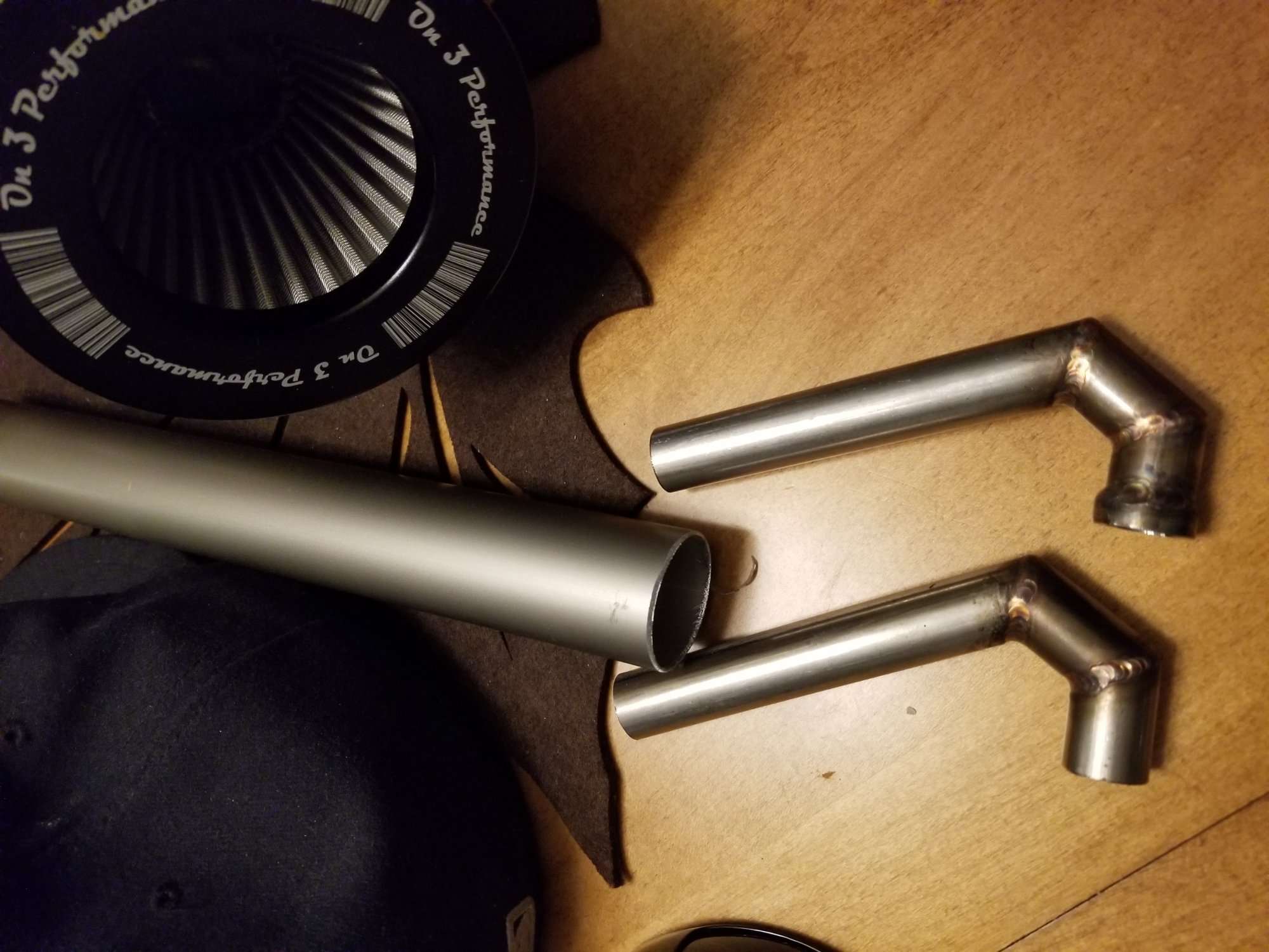

-Himni SS v band to Marmon adapter with clamps
- ON3 90* SS heater tubes

Have the ON3 stainless heater tube pipes and the aluminum lower radiator hose straight connector.  Still worried about the upper house and clamp size but easy and cheap swap out (1.25" vs 1.5").
