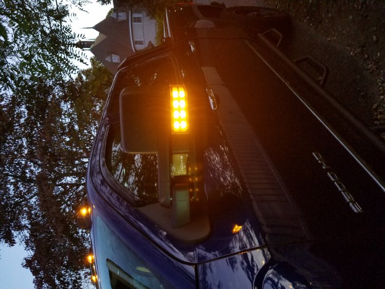

2015 2500HD Silverado with non power folding mirrors that have LED lights in them
Squished
This is the part that doesn't make sense. When I unlock the doors the light comes on.  The amber light does not work in any other circumstance.
They must have tied it into a dome Lamp circuit, indicator light circuit, or other similar circuit behind the door panel.
