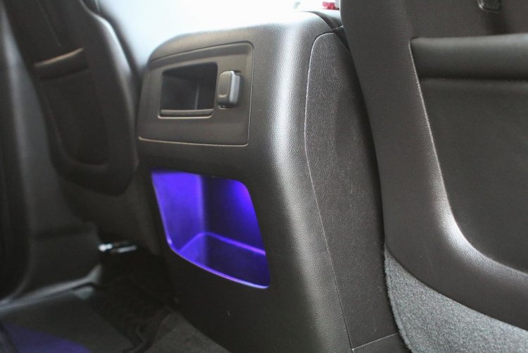

i added footwell lighting under the rear of my front seats that light up the floor of the back of the crew cab when the doors are open.
i also added a light in the back cubby of the center console that is on when the truck is on.  it adds a little floor lighting at night....

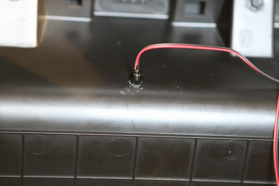

i used the smallest "bolt" light that oznium sells - 6mm with NO lens (in blue to match all the other blue lighting in my truck)
https://www.oznium.com/led-bolt
^^these will likely be too bright to match the front light.  the little light in the front console is crazy small and barely puts out any light at all and i know the bolts are not dim-able
i just drilled drilled a small hole for the light to fit thru.

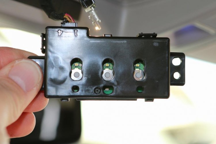

the little LED you are referring to up front is what is illuminated in the back ground of the this pic
