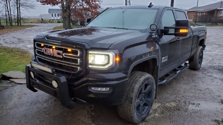

Anyone ever mounted amber lights behind their grill like on the Raptor?  I seem to remember seeing a topic on here a month or so ago where somebody did it and it looked amazing but I can't seem to find it after searching around.  Shame, that thing looked sweet.  Ran an image search and came up with a lot of light bars or Ford trucks mostly.  Anyways if anybody's done this, mind sharing some pictures?  I think it would look pretty great on my truck.

Right on the money.   Here it is:
Ordered some amber rigid radiance pods, a 20 inch, and a 50 inch (it's not pictured because I'm debating on drilling into the truck) but I got them wired up to come on with the parking lights. I love it!
Also for the upper lights:
Quote
They are from superbrightleds.com and they are the 10mm bolt beam lights. I spent a good 5 hours on those little turds, figuring out how I needed to get them, and then I had to get some plastic sheets to cut because if you look at the top of your grille there is only space for 3, but I wanted 5 so that's why I had to make spots for the other two.

So you drilled into the grill mesh for attachment of the bolt lights? Would like to see where you drilled. Definitely interested in doing this now.

I’d be more than happy to take pictures. And yes sir, they sure are. Obviously you can’t have the light bar and cubes on but the orange light is legal. I talked to a state trooper for reassurance. He said they are perfectly legal, as long as they are not red or blue and are not blinding. Which they are no brighter than the parking lights. They are wired into the parking lights so when they come on everything comes on

Here is a picture of them in the grille.
(Please Note) in any standard “Z71 Grille” there is only 3 of the spaces that are completely plugged off. However I wanted to not be mistaken for a raptor (trust me it still happens) so what I had to do was use “Jb Weld” for plastic and I cut some black plastic sheets that I had laying around and attached them with the Jb weld. I then marked the middle of each black space and drilled a hole just big enough to slide the thread of the lights through and wired each of them to themselves, leaving the last one with enough wire to tap into the parking lights. MAKE SURE to put the nut on the thread of each light before you wire them all together or else you will have to cut your wiring just to secure the lights, I used thread lock super glue to make sure the nuts wouldn’t back off and somehow the light fall out. CAUTION when tightening the nuts on the little lights because the threads are plastic and you can easily break them, hence why I used threadlock. If anybody has any questions please feel free to ask, I’ve gotten many compliments on the grille alone and I never thought it would be such a hit. I actually worried people would just start saying “why not buy a raptor” but thanks for the interest guys, hopefully this helps! And yes I do highly suggest doing this with the whole entire grille off the truck.

 Do you have the upper lights wired to a switch inside or do they just come on when you turn the truck on?
They are wired into the parking lights, so anytime they are on then all the led’s are on as well. The light bar itself is wired into the fog light switch. But the orange backlighting is also tied into the parking lights like I said, the picture that they posted earlier in the thread was with the truck remote started, which is my favorite part. I’ve started it in a parking lot coming out of the movies and I love seeing people’s reactions because the lights are so hidden they don’t expect it
