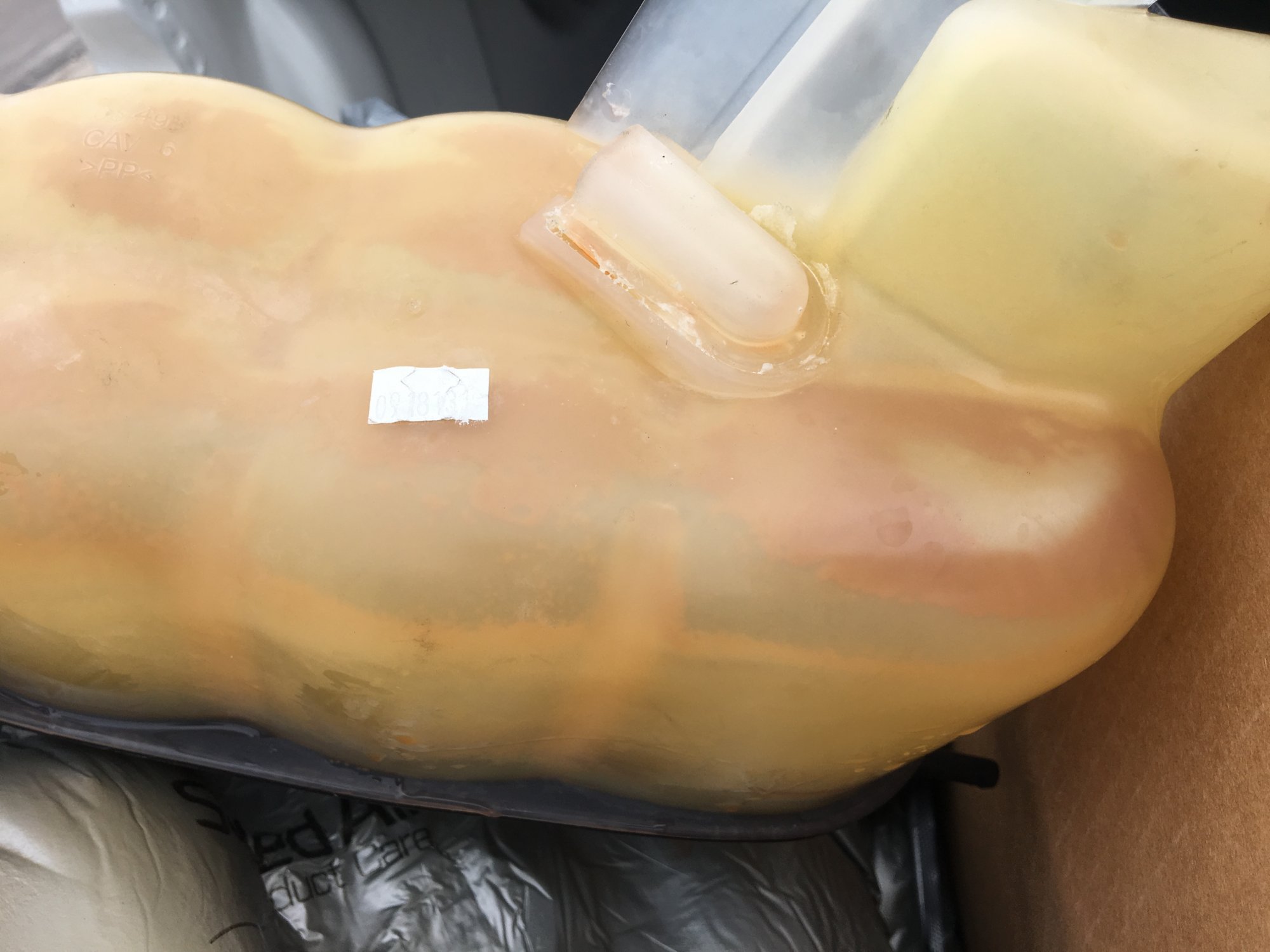

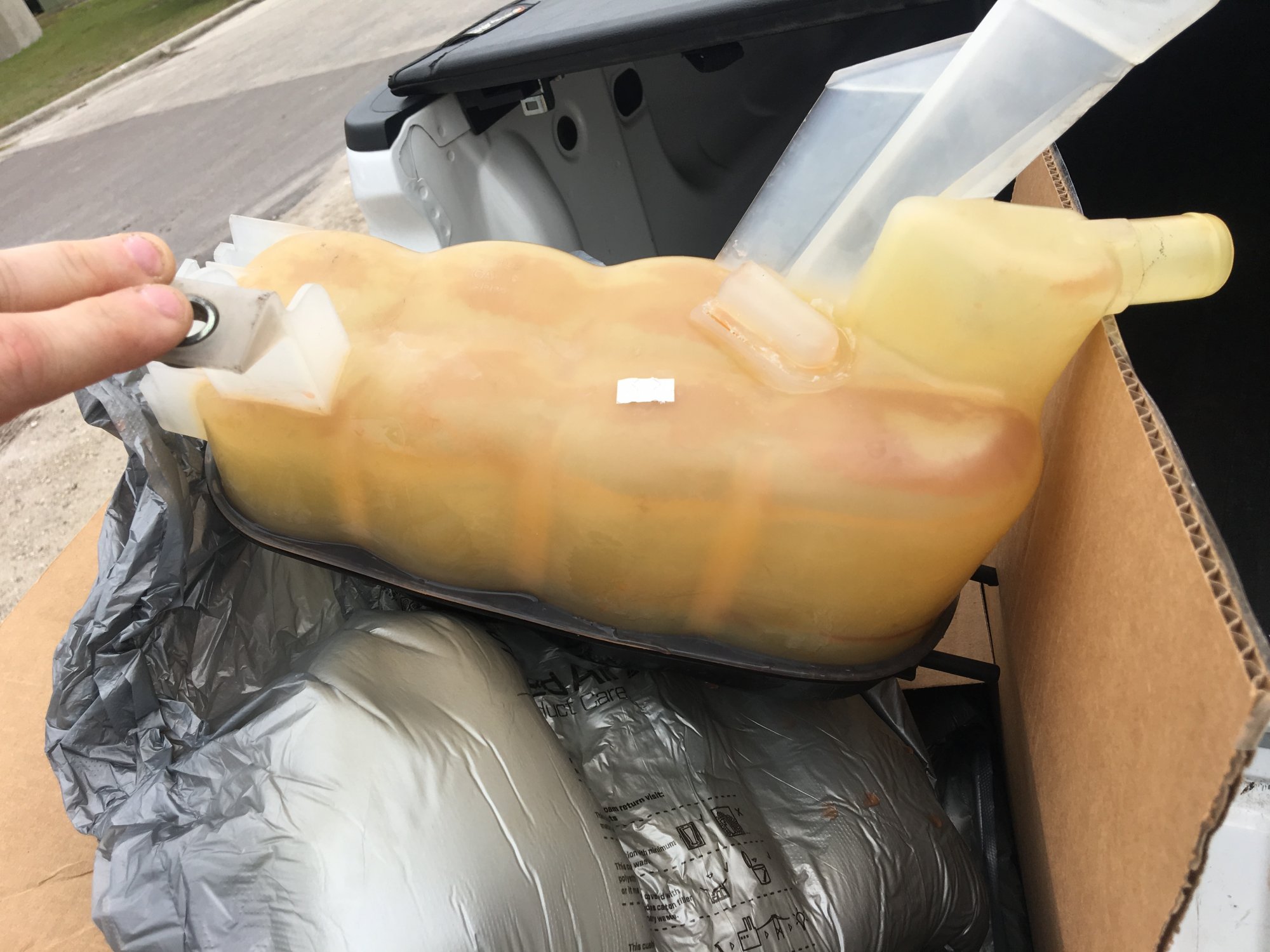

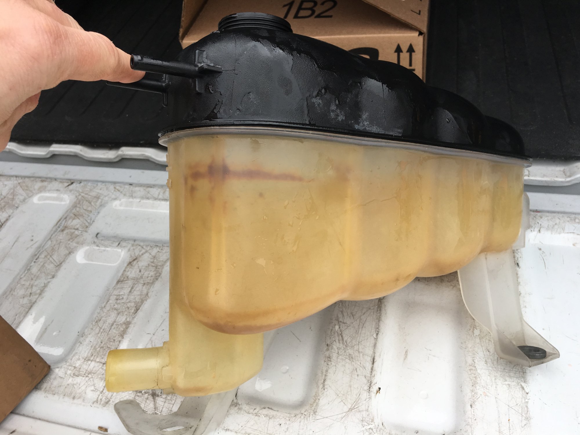

Thermostat came early!  It is definitely a different part # than what my '14 originally came with.  Did the Tstat and Coolant tank today.  Topped it off, good to go for 3yrs/50k.
Good job to you guys for doing important preventative maintenance.
I got the new thermostat when I got my passenger side head replaced and the best part they didn't even say anything to me about it. I found out they replaced it after I went back and looked at the work order. Thanks for the info I will probably flush mine when I change all the other fluids just to be safe.
Pics...  The thermostat was clean, housing was clean.  Everything looked clean except the plastic fantastic tank.  Not only did it have build-up, but the plastic turned yellow.  The tanks when new are WHITE/see-through plastic.  I think the tanks are basically a 'serviceable item'.  Becuase the Cap went bad also, i was loosing coolant and couldn't find the leak... it was the cap.
Since, reading this thread. I have 58K on my 2014. I bought it used from the dealership at 40k.
Gonna try to get it changed and looked at. Whats a good recommened coolant/anti-freeze to use besides Dexcool? Just Peak or Prestone? Since, Dexcool is orange, thought it has to be the same color back in? I know some owners manuals, states that so I thats why I'm asking the question.
