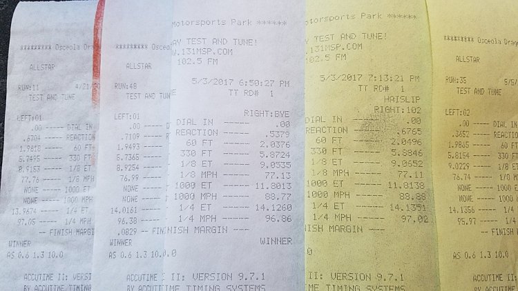

I have not had a chance to dyno my truck but via the HP Tuners software the other night granted it was 20 degrees out it was showing 410hp and 450tq at the crank and I pulled off a 5.56 0 to 60 that night also. That is with a K&N drop in filter, Airaid MIT, Black Widow 250 muffler with the 3rd cat and resonator delete, Klug Performance e85 tune, Black Rhino 18s, and Falken Wildpeak AT3s 265/65 18R. That video was with the stock wheels and tires. Last year I ran one 13.96, and consistent low 14s full street weight. I am hoping with the flex fuel sensor I'm going to install and the Circle D converter I will see a 13.7x with good air and consistent high 13s.
Hmm that should be about where my 6.2 sits for quarter miles. I’ve seen slips of all stock crew cab with 6.2s in the 13.7-13.8 range.
