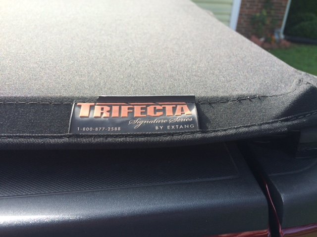

I moved a Trifold cover from a SB 2009 to a SB 2014 and then actually to a 2016 SB it was a bit different bed size it seems like the cover was a bit short and maybe not quite wide enough but not that noticeable.  I would hazard a guess that a camper top (topper) would not be as forgiving on those dimensions though.
