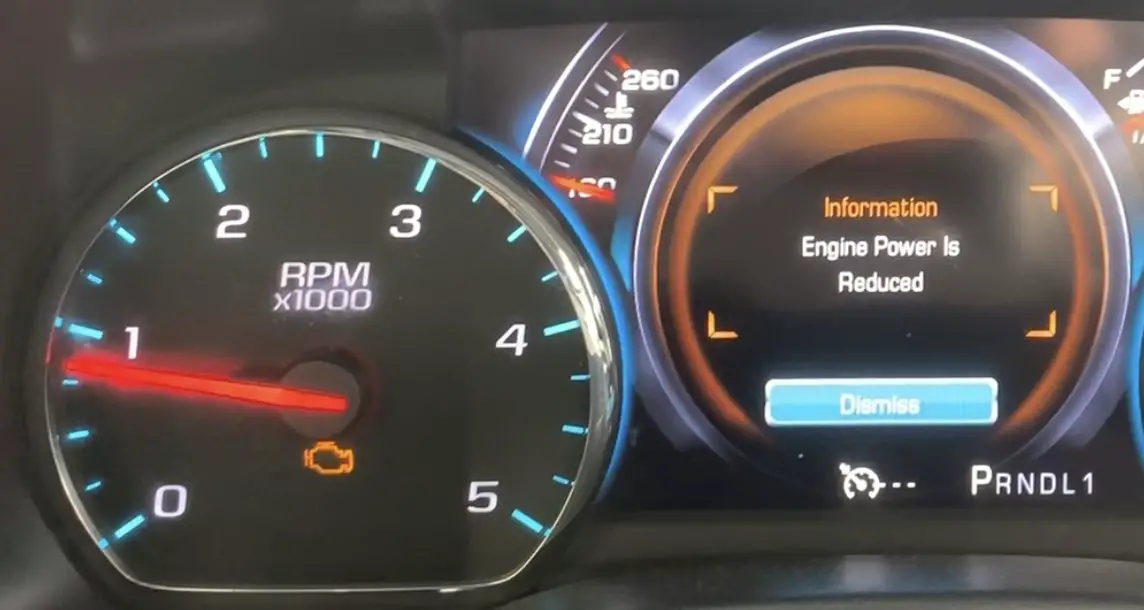

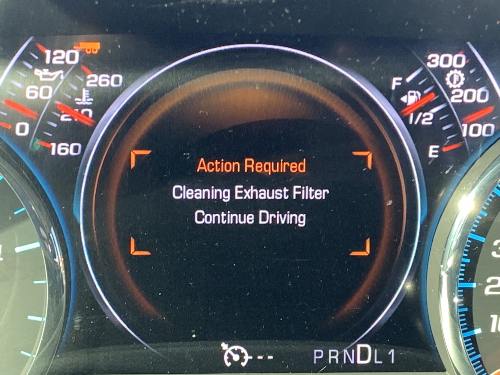

Regen  issues and multiple trips to the dealer. I bought a ‘17 2500 with 20,000 on it the first week of December ‘18. It’s now the second week of February ‘19 and I’m at 31,500. Cosmetically it’s had the heated steering wheel replaced and needs a gear selector, mirror marker light, leaky oil drain plug. Mechanically it’s been a damn nightmare!
It’s had the EGR coolant hose replaced due to a leak, coolant reservoir replacement due to the constant “coolant level low” light. It’s gone into “Engine Power Reduced” mode 8 times! Pretty much every time I drive the truck it gives me the message “Cleaning Exhaust Filter, Keep Driving “ for at least 20 miles. I’ve changed out the air filter with AC Delco OEM filters 7 times. The last time I brought it in to the dealer I was told that the problem was likely due to a clogged air filter which was a maintenance issue and that for $350 diagnostic + install a new filter and force regen it should be good. I declined. They did a regen on it and said the DPF was 95% clogged but now it was clear.
Two days later I drove home to Montana (1,100 miles) with no issue. On the way back to the Denver Metro Area two weeks later it was -12° so I added a healthy amount of Power Service and kept the tank relatively full. 300 miles into my drive in the middle of BFE while climbing to the continental divide the truck started sputtering as if the filter was clogged! I pulled over at the summit and added a bottle of diesel 911 and crossed my fingers. I carry an extra fuel & air filter so I could have changed it out on the side of I-90 if needed but this really made me reconsider my choice of vehicle! Not 50 miles later I stopped and topped up my tank and changed my air filter just Incase. When I started it back up the traction light was on and stayed on for the duration of trip (12 hours with no cruise control). Once I reached Denver I unsuccessfully attempted twice to make a service appointment.
Over the the next few days I towed a few loads between 5&7k lbs through the Eisenhower Tunnel and was surprised that it hadn’t gone into “limp mode” as it usually does seconds after turning on the exhaust brake upon exiting the tunnel, it only stayed in “keep driving or else” mode for 45 miles! Now she’s parked until Tuesday when I have an appointment at a new dealer for yet another coolant leak and this damn regen issue. I found this thread while looking for options to keep the hood scoop from drawing in moisture and clogging air filters with ice. Ironically I read one article where GM states that their new cold air intake was tested at the Eisenhower Tunnel! That’s exactly where I seem to experience most of my issues! High elevation and a load = make an appointment for service.....again!

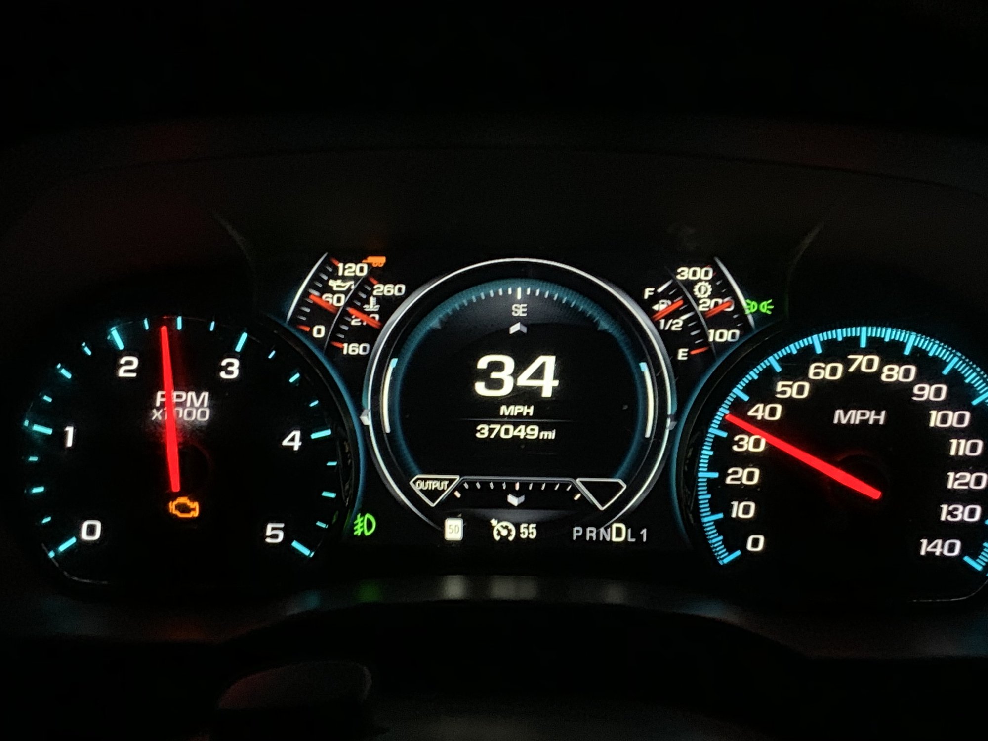

Got my truck back from the dealer last Thursday with a new EGR cooler. It’s now the following Tuesday 3/5/19 and my truck just went into “Reduced Power Mode” 130 miles into a 400 mile trip!!!! I’m now in BFE towing a 6,000 lb trailer going 45 miles an hour on the downhill sections. It’s -10 and not survivable if I need to walk. I’m going to rip this damn DPF out and use it for target practice! I’ll be dropping it off again as soon as I get back to civilization and hopefully I’ll get it back within a week this time....although making payments on a truck that spends more time at the dealer than their “for sale” trucks do is really awesome ???
