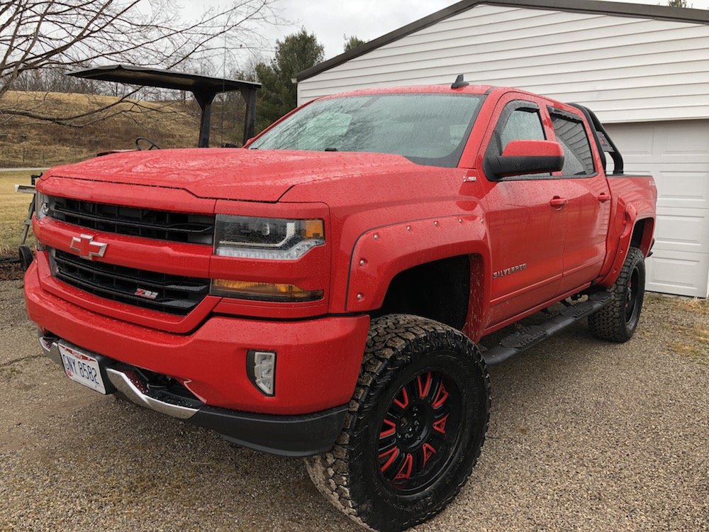

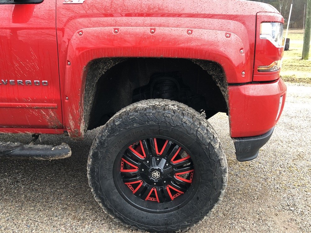

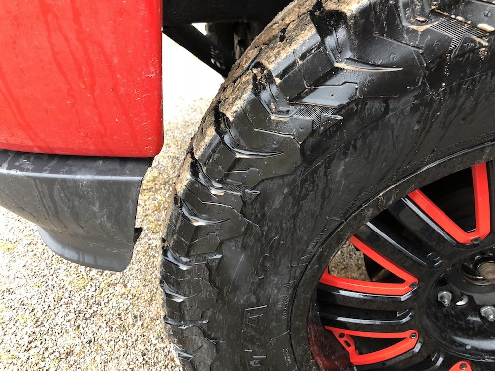

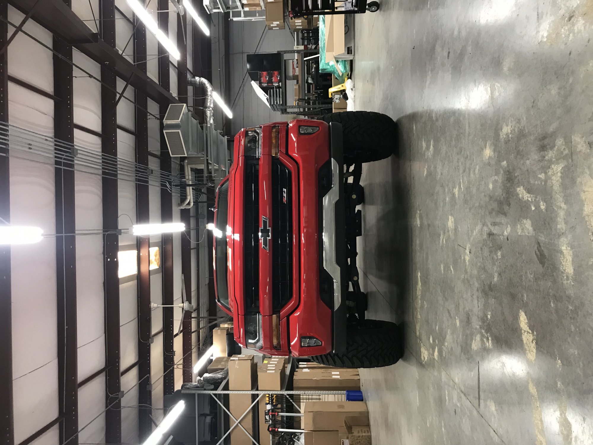

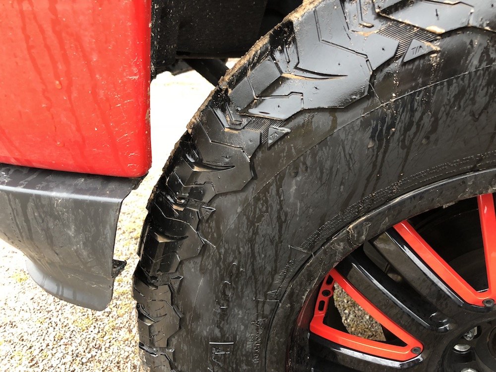

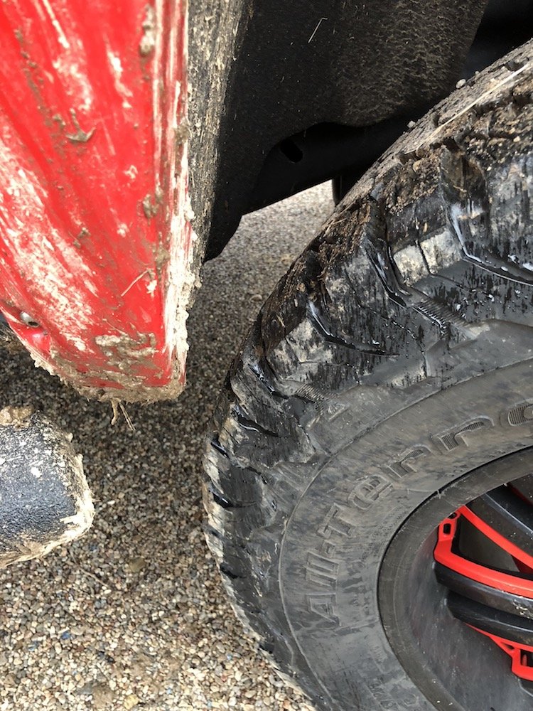

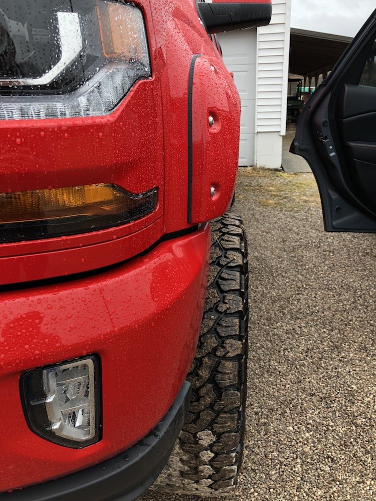

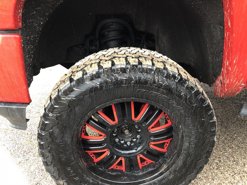

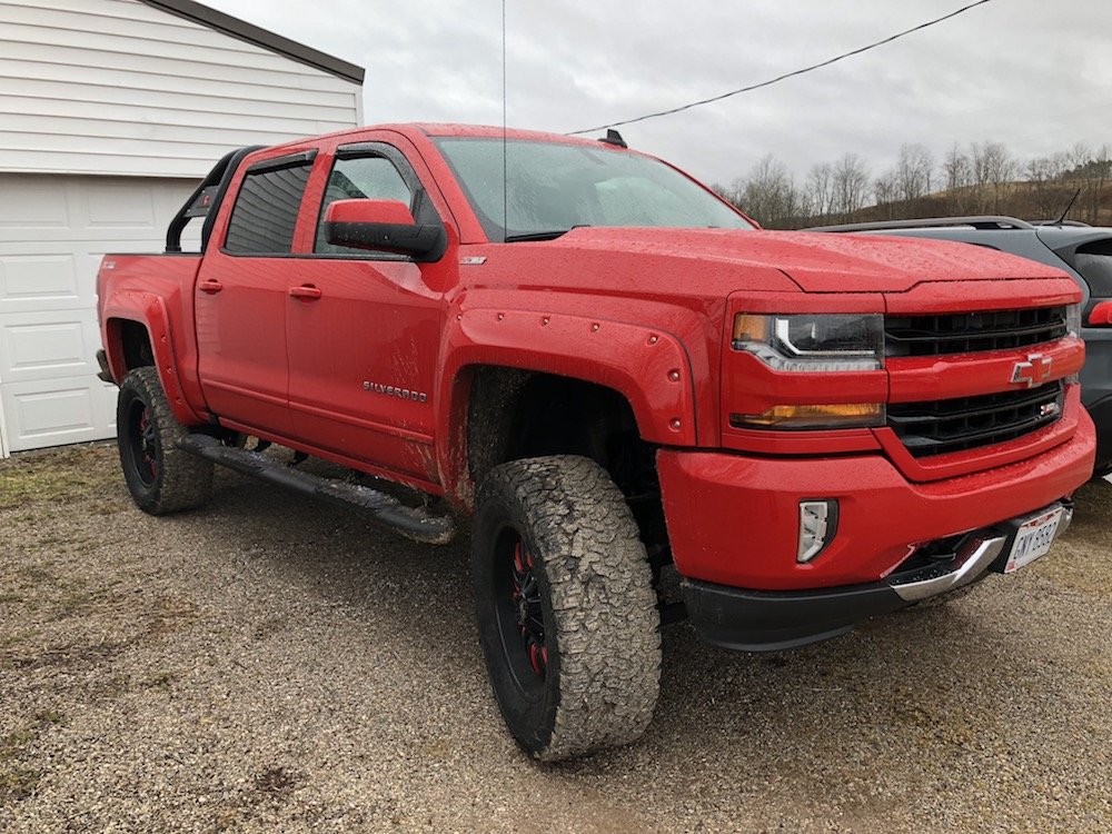

Here are some photos, I haven't been under the truck to check the offset on the wheels but based on manufacturer specs they are either +18 or -12.  It looks like if you push the wheels out further you might run into the tire hitting the front bumper. Clearance toward the cab looks like it would be enough, but it could be tight when flexing, granted I am running flares so I lose some clearance there anyway.

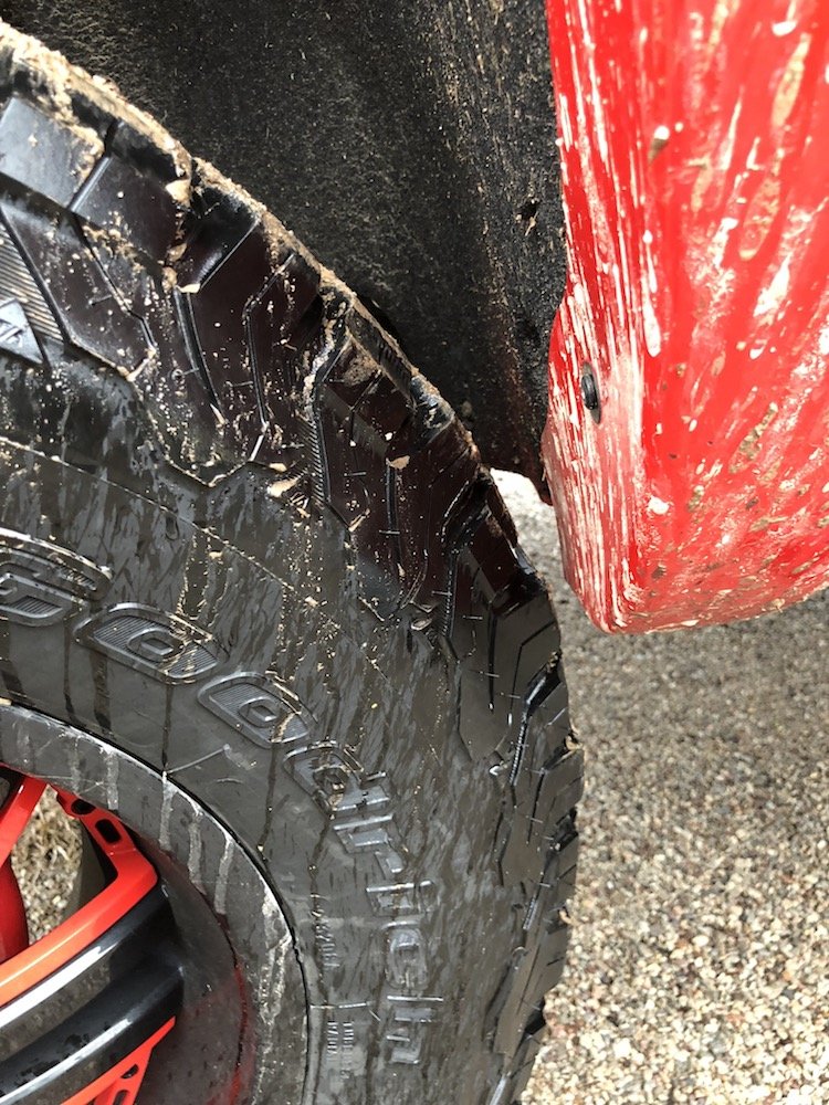

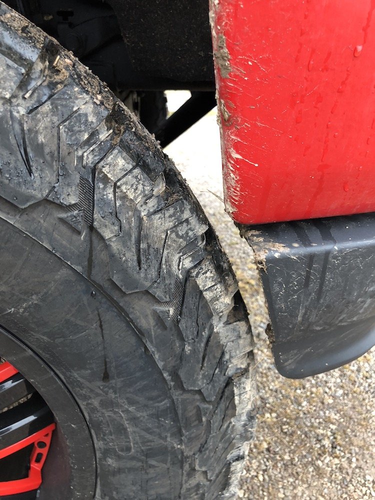

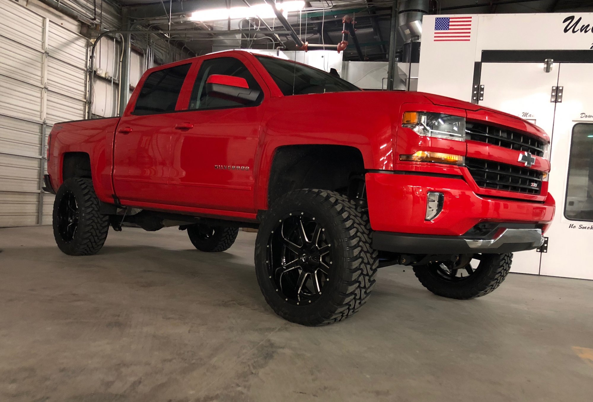

I just lifted my 17 ' last week with the same exact parts as what you are saying but added the front skid plate also.  Installed Fuel Mavericks 22X10 with a -24 offset.  Toyo Open country MT's 35X12.50X22.  I had to trim the loser valance, about 2 inches off the splash shield in the front, had to trim the little plastic guards at the rear with some of the splash shield at the rear also.  I still have rubbing and very little room in the places that arent rubbing.  I can say that the offset you are saying will be worse.  Don't see you fitting 37's without major trimming and a lot of rubbing.

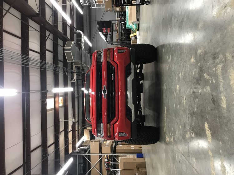

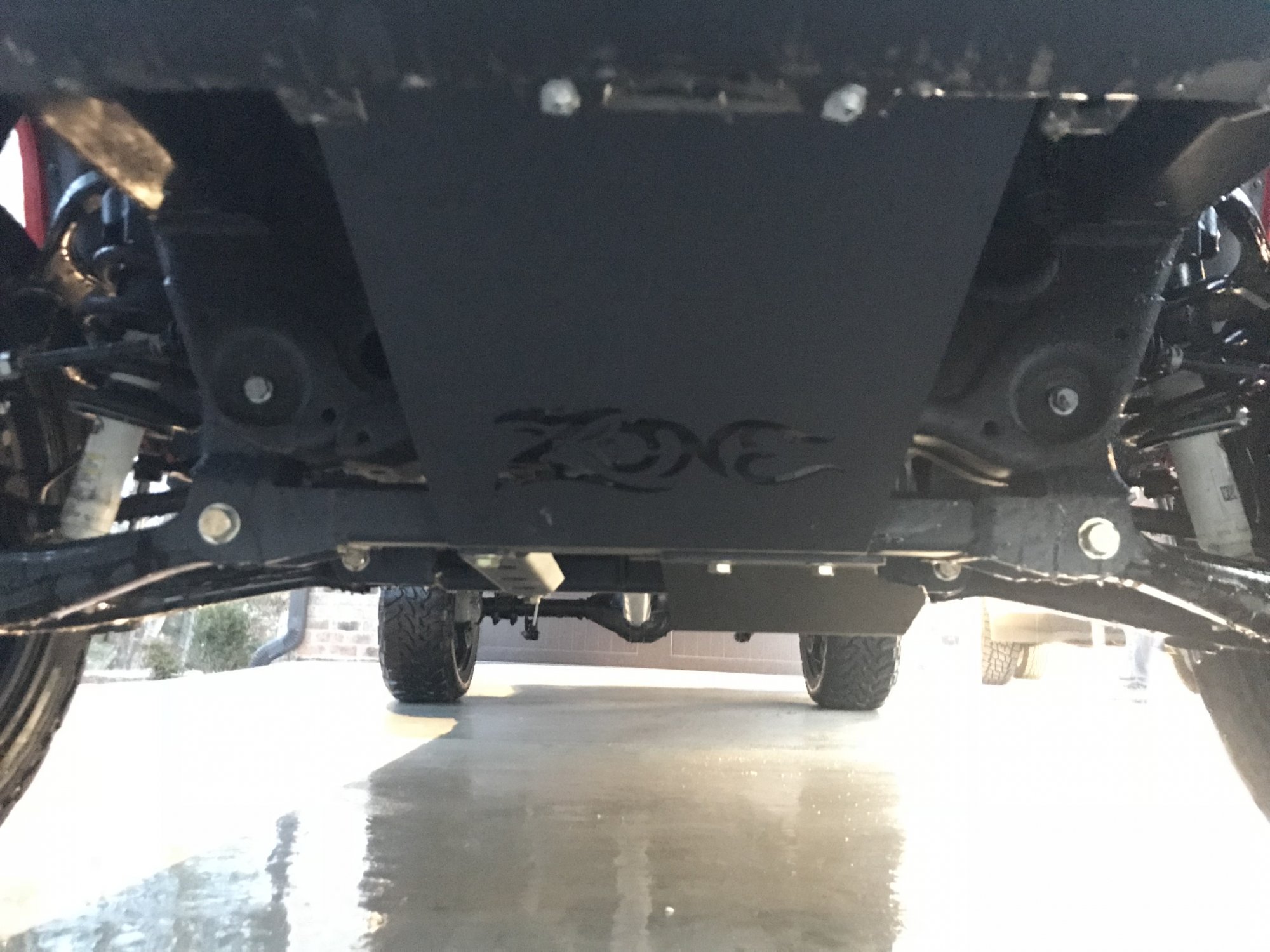

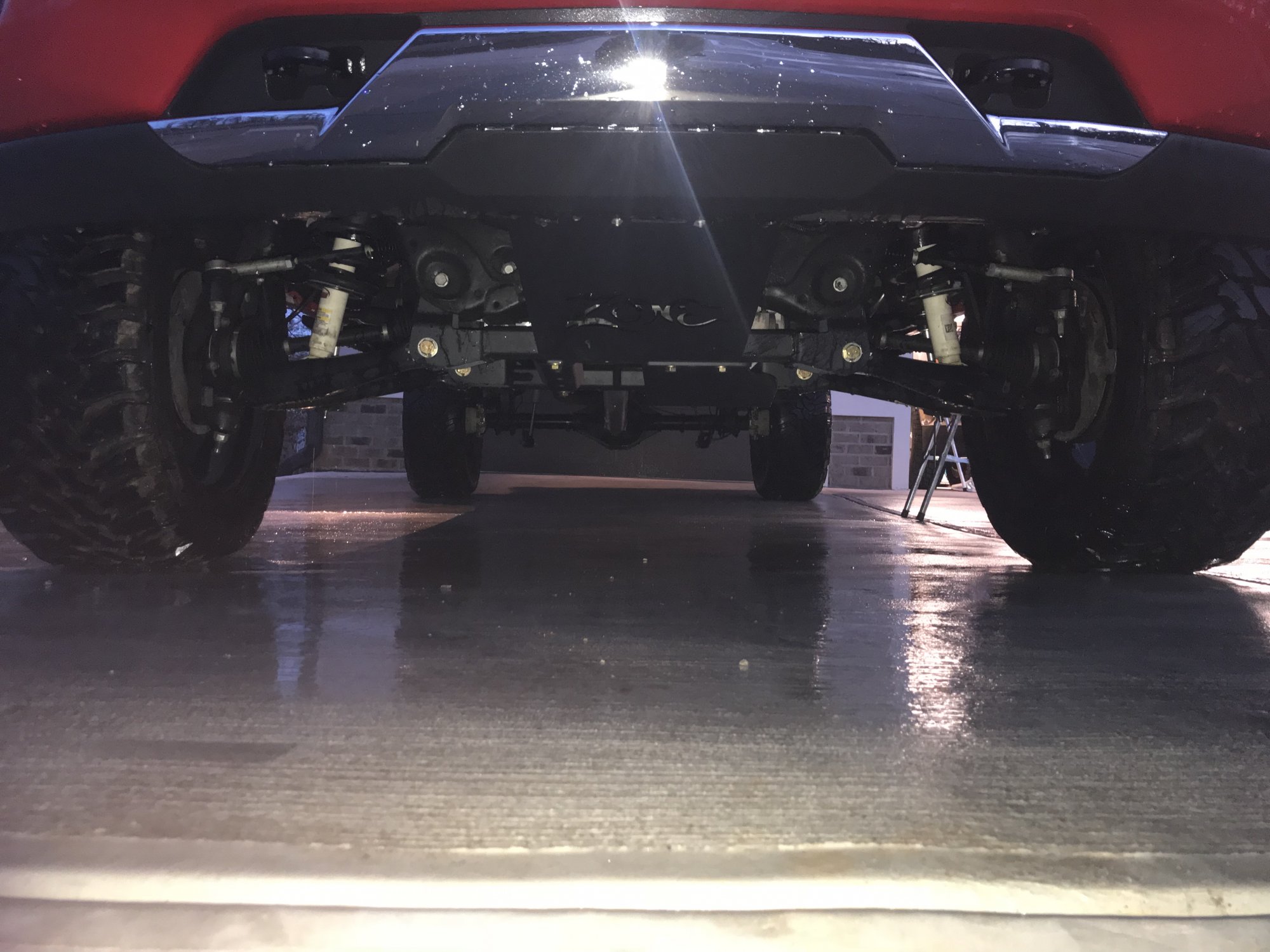

Pics of Fox shocks in the front?
Also, pic from front of skid plate?
The add on Fox shock option is just the rears.  I did not order the front struts separately and not sure that I will.  The Ranchos that came with the Z71 package ride good on it and were not required to lift it.  You are looking another 800.00 roughly for the fox front struts.  I don't have a picture at the moment of the front skid plate but if you look at this picture you can see the bottom of it barely.  It just kind of goes in place of the factory cheap on that you have to remove.  It does have Zones logo cut out in at and for the 60.00 bucks or so it is worth it.

Yea you can buy the coilovers in the front but they are standard length. You still have to run the spacers is all.
The skid plate doesnt really stand out from normal viewing but I feel like it adds a little to tie the new crossmember in.

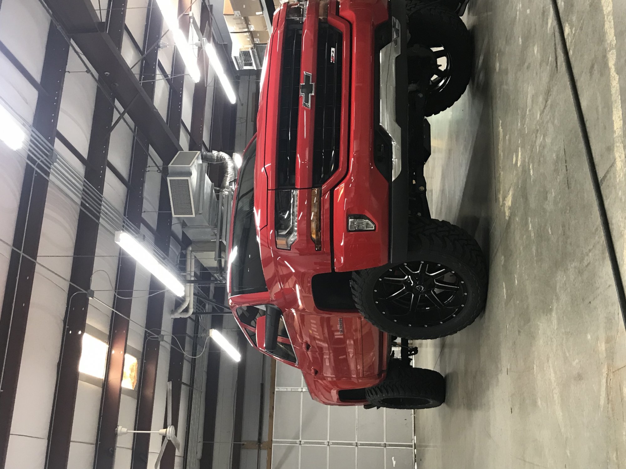

The lighting on these arent that good either but here are two more views.  I am posting from my phone so don't know how to rotate them  Sorry.
