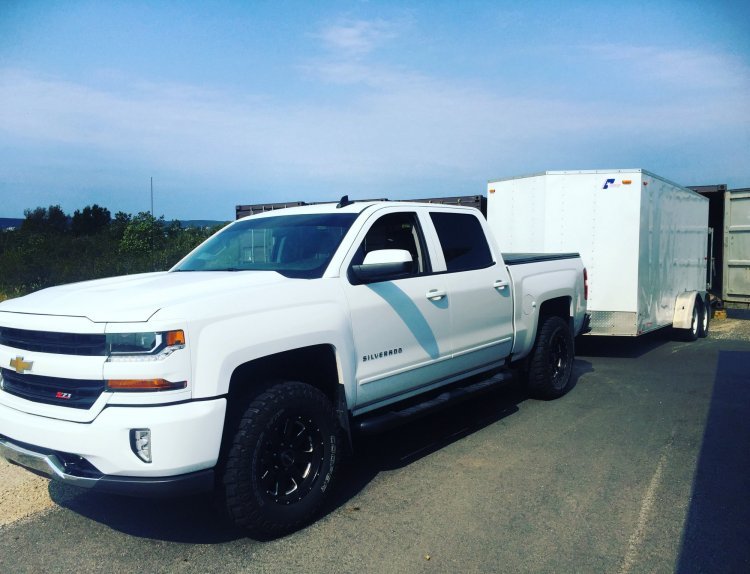

Here's a pic of a 16' enclosed trailer, steel
chassis, tandem axle, with electric brakes. I typically set the gain @ 1.0 on the stock trailer brake. LT tires really help me here, there's 2 sections of steel scaffold, 50 sheets of 1/2" plywood, tools, and other odds and ends in that trailer. I'd guess somewhere around the 7-8k lb mark, no issues
