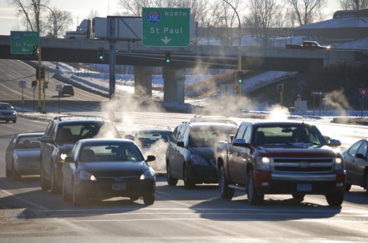

This may sound stupid but was there a car ahead of you to the right at all (I know you said nothing there, but maybe where normally it wouldn’t pick it up) like maybe at a stop light? I ask because on cold days, when I’m sitting in traffic and a car that is still warming up putting out a lot of steam/exhaust (you know when you start your car when it’s cold and clouds of exhaust gas billows out) out, my sensors pick it up. Happens on both sides just depends on where they are sitting. My sensors would not pick up the actual vehicle, just the foggy mess coming out the back of their car like in the picture...I know it’s a long shot but figured I’d at least share my experience. The sensors never fail or give false warnings except when they pick up this exhaust from a car slightly ahead of me on either side.

Not a bad call, they will pick up cars in front of you, cars going through the intersection, and so on. Most times I think they designed them after the Munster's episode when they trapped Grandpa as a bat and thought he was drunk flying around, because his sonar did not work so well.
They went through everything and the warranty is up. Nothing in front or on the side when it goes off.
