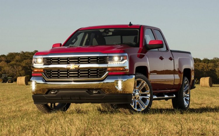

What am I missing here... whats the difference between my LT's headlights and the LTZ?
LT headlights are HID, LTZ lights are LED.  Also LTZ has a switchback LED turn signal instead of the halogen turn on LT.  Here is a couple pics. LT is on top, LTZ in bottom.
