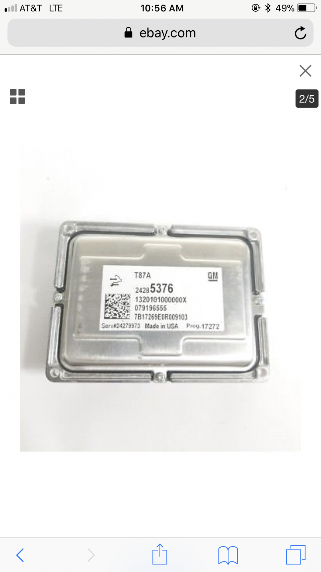

I’m wanting to get my 17 Sierra 6.2l with 8 speed tuned but the only thing that has kept me from it is sending off the TCM to be unlocked. I’ve found some that claim to fit my truck on eBay but don’t want to order until I’m sure they will. The ones I have found all have the same serv# as my current TCM and are also all T87A. The picture with the numbers that are circled is of my current TCM and the other is of one I found on eBay. Would it work? They say they are new and never installed so I would have to have it flashed to my truck before being sent off if they do work.

I would call HP Tuners on Monday and ask them if it will work. They should be able to let you know before buying one.

The other way to do it is get s 2016
8 spd  used TCM from a truck then it can be tuned the normal way no unlock needed by efi live or hp
That is correct. You can use a 2015 - 2016.

I’ve wondered about that but never knew it would work. That would be a lot easier and somewhat cheaper. Anyone know the part number for one? It would still have to be flashed for my truck though correct?
I would think the spare TCM would have to be VIN matched to the truck it was going into. You may run into communications issues between the BCM, ECM, and TCCM. Additionally, there might be a problem with component protection, and the truck may not start.

I’ve spoke to HP about it and they told me that I can use a spare it would have to be flashed with my current trucks info before sent to them to be unlocked. I’ve talked to 2 separate tuners that use HP and they also have told me they can get me a spare tcm to use so that I’m not out of a truck waiting for the tcm to be sent back.

I dont think they are right, the ECM/TCM/BCM and most of the other modules are all VIN locked to your VIN. Anytime you change out a module the vehicle has to be hooked up the GM Global network and the module updated in order for it work again.

They’ve claimed to do it more than once. Plus I don’t understand why they would tell me to do it when it wouldn’t work. I’ll talk to them tomorrow and make sure it does work because what you said sounds completely possible.
I understand, just going off of what I know and have heard other techs confirm.
