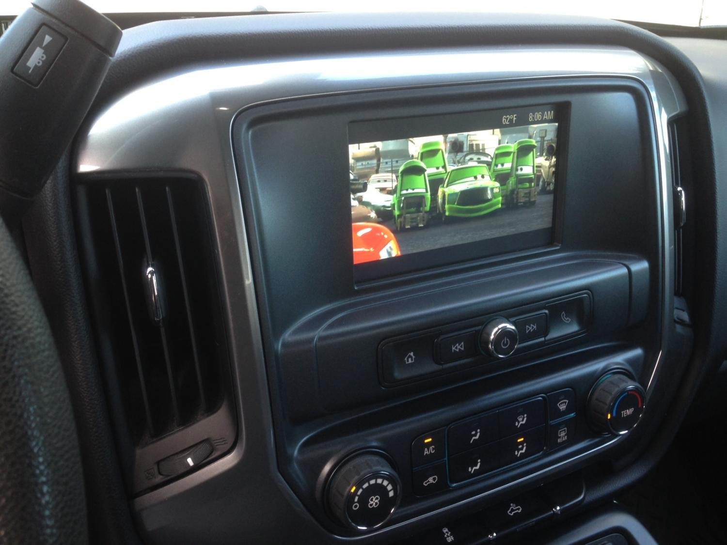

I replaced my 7" IOB with the 10" Alipine x110slv Restyle kit/idatalink Maestro and it is completely plug n play with no factory wire or dash cutting. The Maestro maintains "most" of the factory functions and whoever told you that B.S. about swapping radios voiding the warranty should read up on the Magnuson-Moss Warranty Act.
IMG_1442.thumb.JPG.5d573494991a08c41c00cb708441af39.JPGIMG_1443.thumb.JPG.4dfa8b8d63a6f120113dd88259e6eba1.JPG
