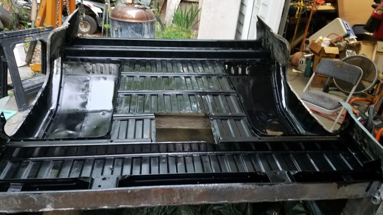

Well, I have failed at that, but here are some:
All metal work to the bed done.  Some body work still left.  Bottom of bed coated yesterday.
Will flip and do the topside soon.
