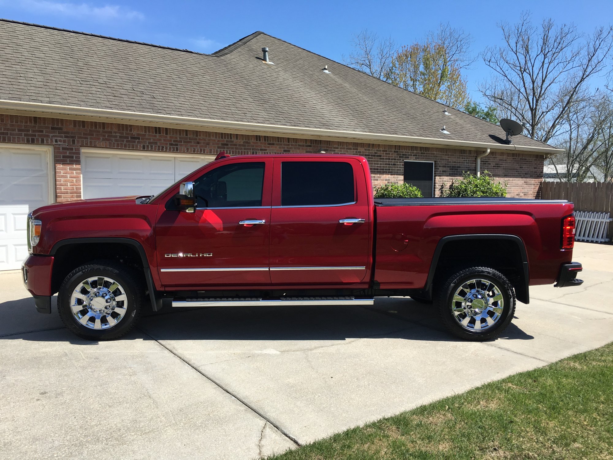

I've had 1994 GMC , 2000 Silverado LT, 2005 GMC SLT, all 1500's. the 2000 & 2005 were 4wd. I ordered a 2018 GMC Denali 2500HD CC z71 4x4, October 1, 20017. Got it in November. I went back and forth on a 1500 max trailer 6.2 and a 2500HD, for three years! I didn't want or need the diesel. I was hoping GM would make the 6.2 with a iron block. Didn't happen. So I read all I could find, about the 6.0. Pretty much bullet proof, if you service it. The ride around town, is a little stiffer, if you have to go on rough roads. The ride on the interstate, unbelievably smooth and quiet!  (Also; my neck and lower back are fused!) The gas milage around town, not much different than the 5.3"s. Interstate at 68 - 70 mph, 13.7 - 14.6. Not what I was hoping for, but I already read it probably would be less than 15mpg. I have 8600 miles on it now. Would I do it again? ABSOLUTELY! I Love this truck! I will never go back to a half ton. Bigger and better brakes,frame,etc. The price difference between a 1500 and 2500HD, is really small. I'm not pulling anything right now but a 3500lb utility trailer. Loaded with 3 cubic yards of mulch, I can't hardly tell it's back there!  Looking for a Sea Ray 280 Sundancer( 8500lb) now. I think if your willing, to give up a little ride comfort around town and know your milage, is not going to be great. You will be happy you got a 2500 HD. Good Luck!  here's a pic. of mine.
