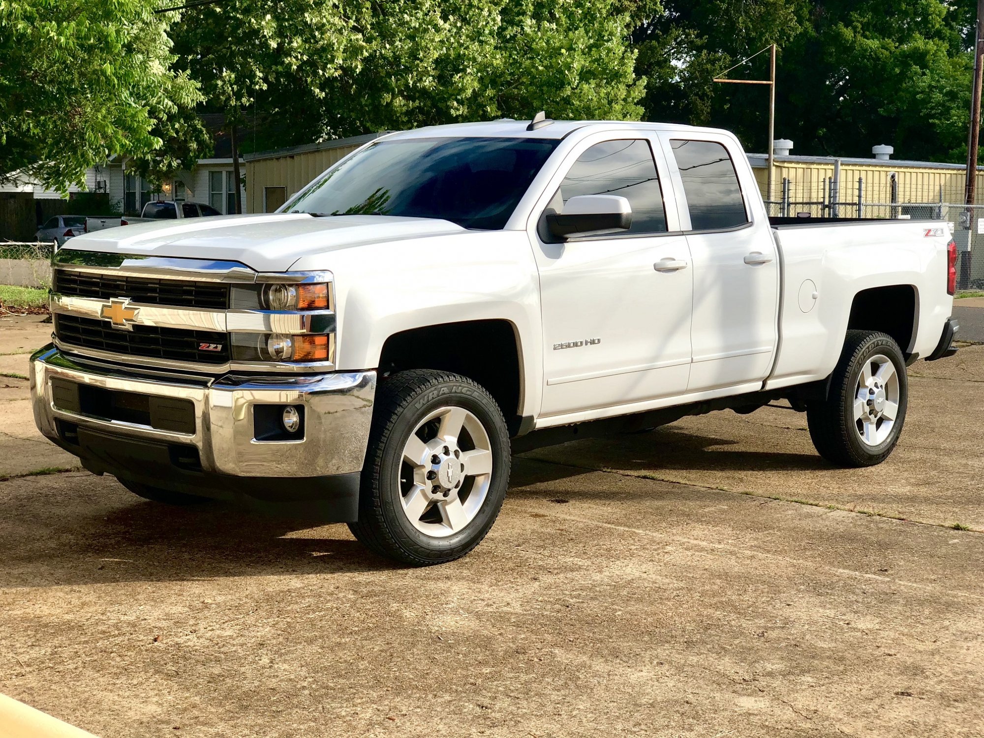

I sure appreciate y'alls input! Lots of good info. Here's an update... I went for it! I bought the 3/4ton yesterday! Obviously I will need to put some more time in it to make an accurate assessment over various road conditions, but driving it home (only 2 hours on the interstate) my initial impression is: HOLY CRAP THIS IS SMOOTH!... So far, I can't even believe I thought it was going to be an issue. I absolutely love it so far. I sure hope I'm not speaking too early...fingers crossed! Here's a picture of it:
