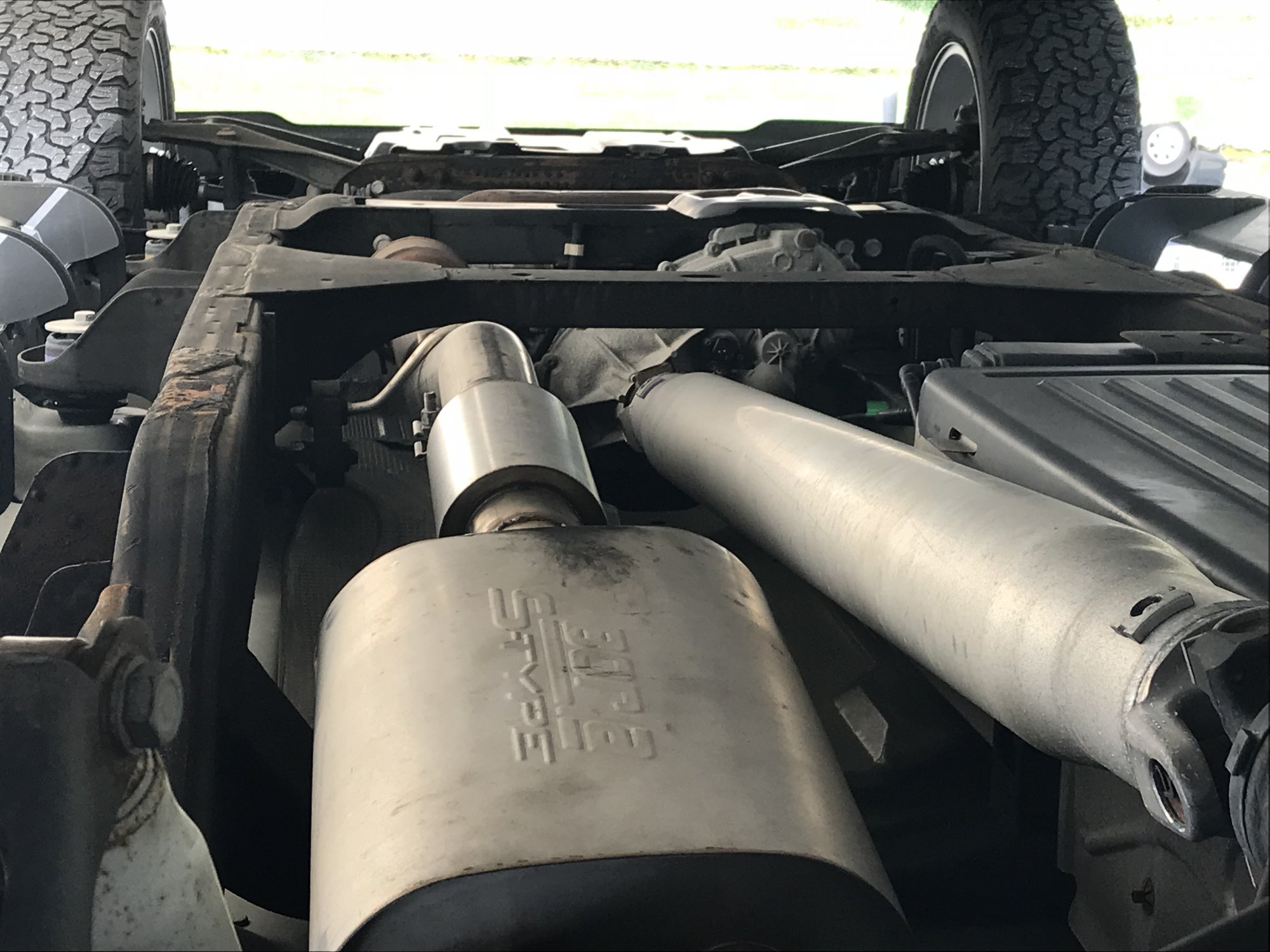

I own a 2014 6.2L GMC Sierra 1500 Denali.  I bought a Borla dual side exit Sport exhaust a year ago from the Borla we sight, and it’s just too loud. In my efforts to quiet up the exhaust some I’ve come to two possible solutions.

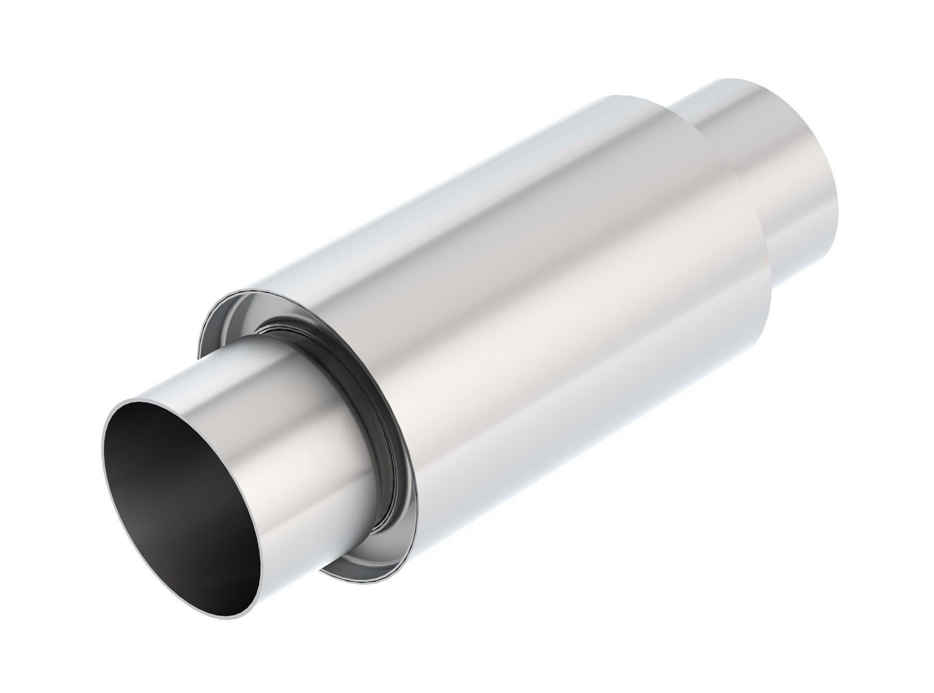

 One would be to have a Borla race muffler welded onto the front pipe of the current exhaust ( I’m adding a picture to this threat: https://www.borla.com/products/xr1_sportsman_35_centercenter_8x5_round___racing_muffler_part__40004s.html) or My second thought is,  I found this item online and I was wondering if I could just plug the muffler the “OEM Borla Touring exhaust “ (https://www.gmpartsdirect.com/oem-parts/gm-14-17-borla-r-6-2l-dual-side-exit-cat-back-exhaust-system-crew-cab-short-box-double-cab-standard-c-19303345)

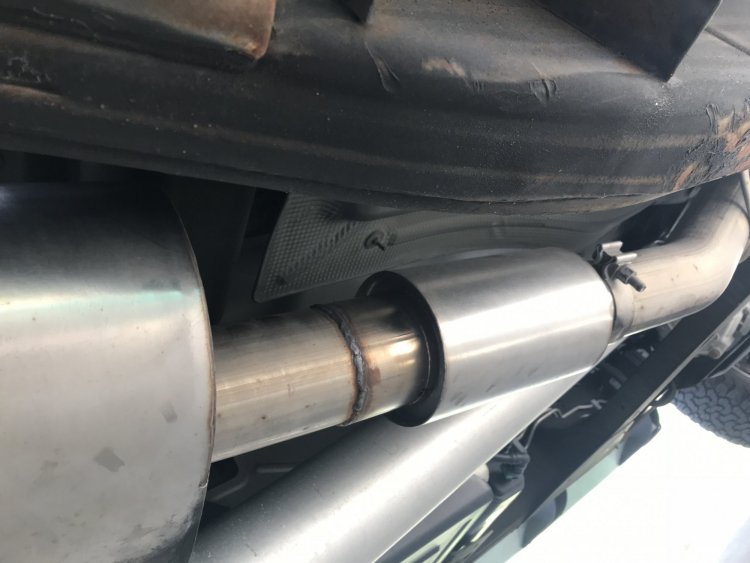

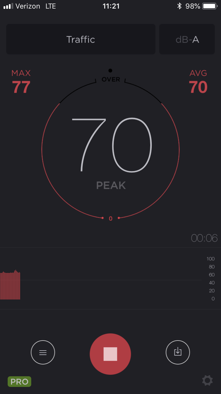

ust to update. I went with welding in the small XR1 race muffler. It actually works perfectly. My dB meter confirms. I was getting a constant 85 plus on the highway. Now I’m in the 70s. So anyone with a s type muffler I recommend having one of Borla XR mufflers added into the system to kill any highway drone.
