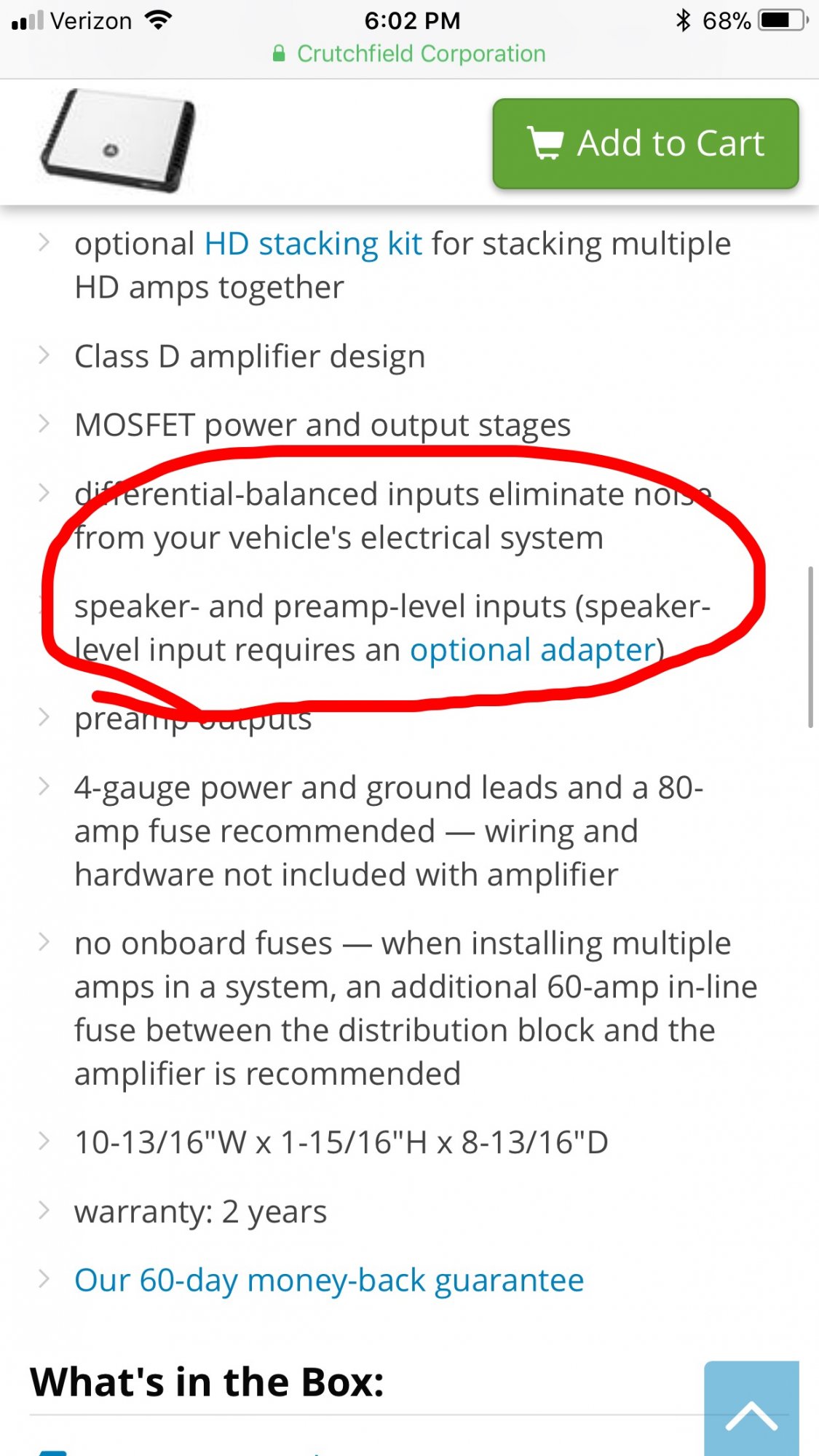

Do you know the exact model of the amp.  Looking up 750/1 on their site only returns the hd750.  If that is the amp it does NOT have high level inputs and would require a separate LOC.  Lc2I is great and I've used them several times personally.
Yes that would be the one. The tech mentioned that as long as the amp has speaker lever inputs the LOC wouldn't be necessary. Here's the description on the site.
