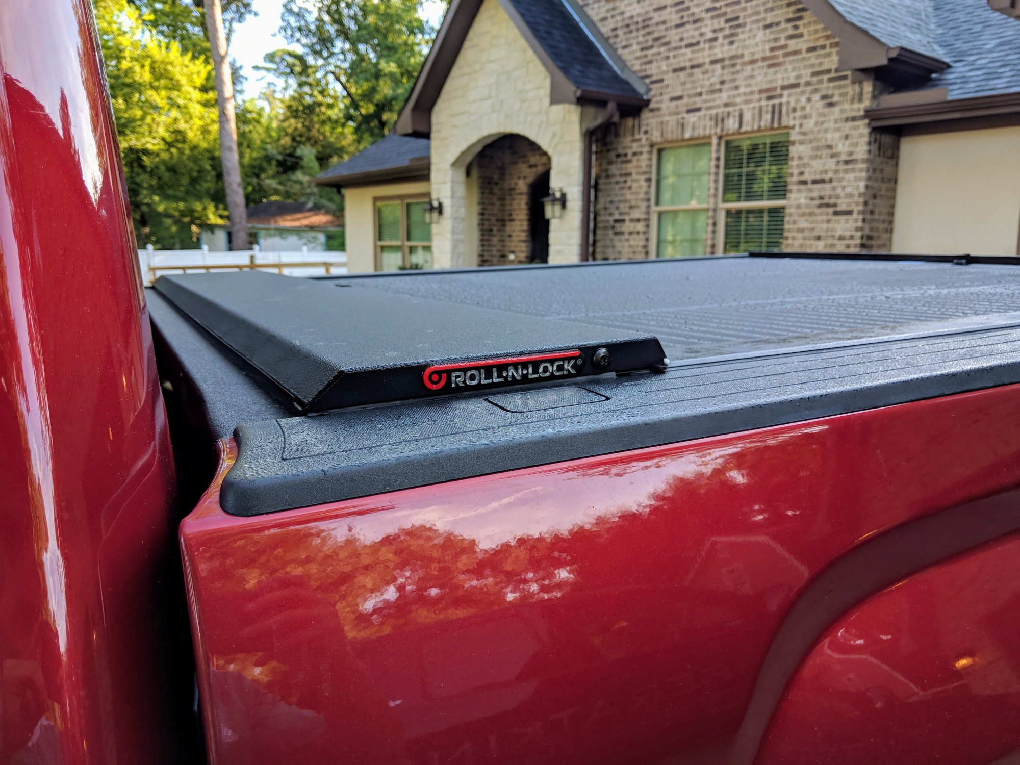

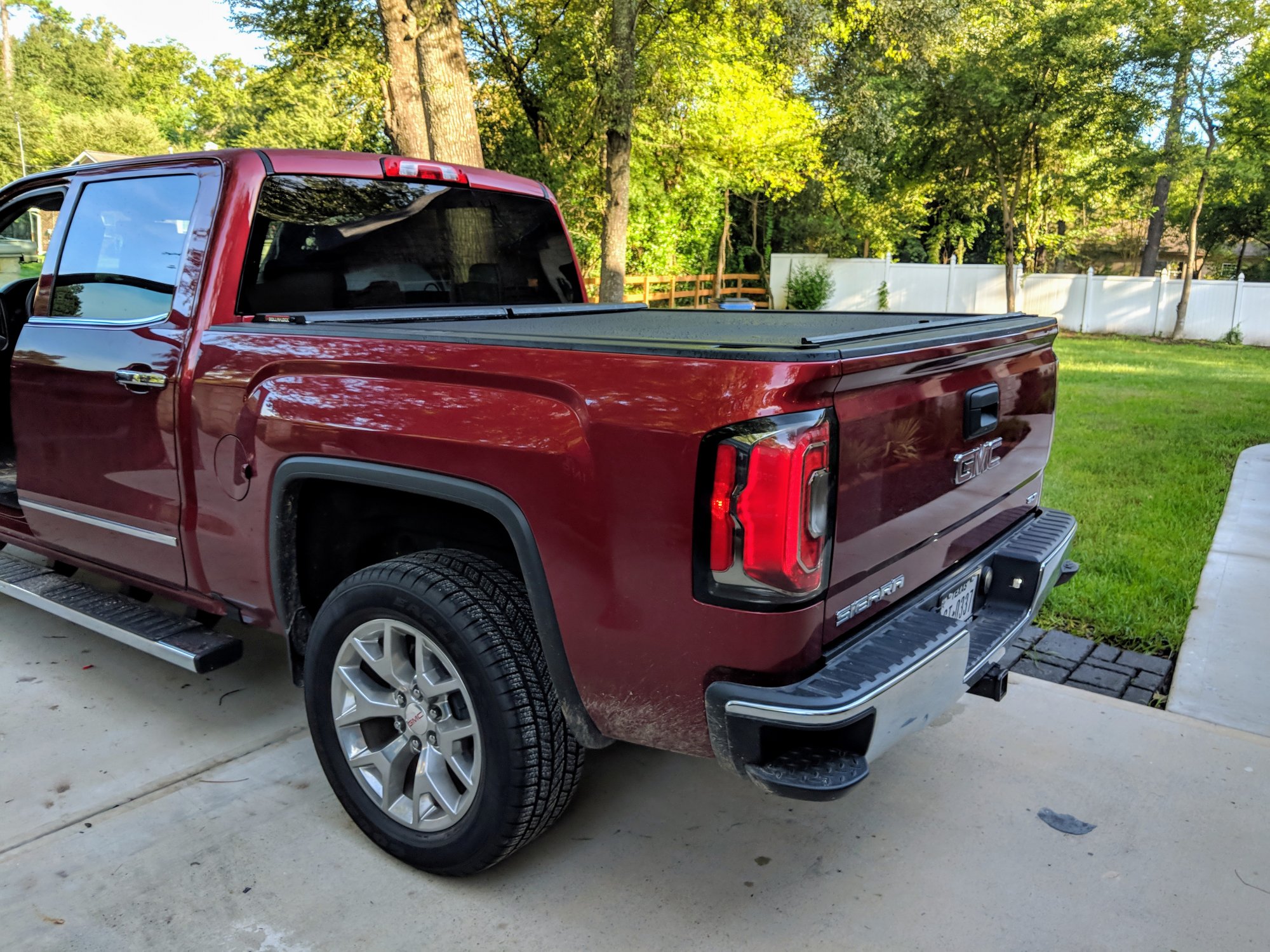

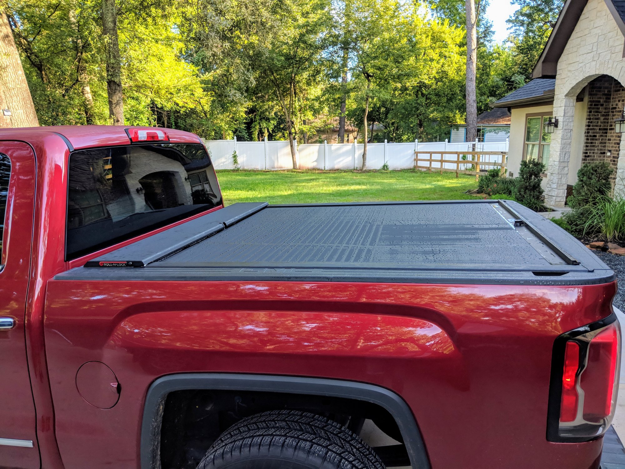

Got this bad boy installed yesterday...
I had to cut the tracks to make it fit but roll.n.lock gives you all the info you need.

When you slide yours back, does it fly back easily or do you have to give it solid push?
Sometimes a good push due to it never really being used. Apparently, you’ve got to be using it a bit in order to get it broken in but if it’s only being used a couple times a month it’ll take a bit longer to break in.

Oh ok cuz i've seen some videos on youtube and the guy basically flicks it and it flies back into the housing...
I like how it is now i feel like its easier to control.
Also did you do anything to waterproof the bed?
To be honest with you, it’s closed months at a time and only use it occasionally depending where I’m going. Waterproofing is easy, during install I had the install guys run a bead of permatex liquid gasket along the flimsy foam gasket provided by factory. The only place water is getting into is from the tailgate and apparently there are foam type gaskets available for that but quite honestly, you can better make one yourself with the adhesive door trim you buy at Home Depot. Just be careful not to make it to thick so your tailgate will still close.
Btw, your truck looks great, love the color accents along with your RollNLock. Great choice!

Yea I need to look into that since i'll have some tools in there from time to time.
Thanks m8! I'm trying to get rid of all this damn chrome though...
