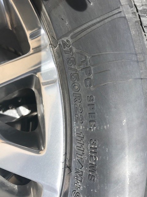

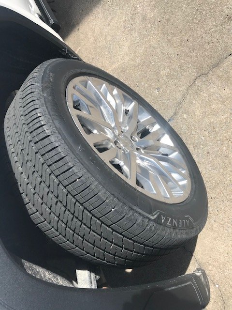

OK guys I am going to try something different thinking "outside the box" this morning.
I just called Bridgestone warranty department directly (yes they actually answered the phone on a Saturday) I was told to take the truck to one of their local branches and have their people check the tires for defects. I am going to give this a try.
I have an appointment for next Saturday at 7:00 a.m. to drop it off at a local Bridgestone location.
I will try to remember to keep the thread updated on how this works out after the visit. Cuz if it is smooth as glass I may forget LOL.
If you don't see any updates after next weekend hit me up. Have a great week and Feb 29th LEAP DAY.
