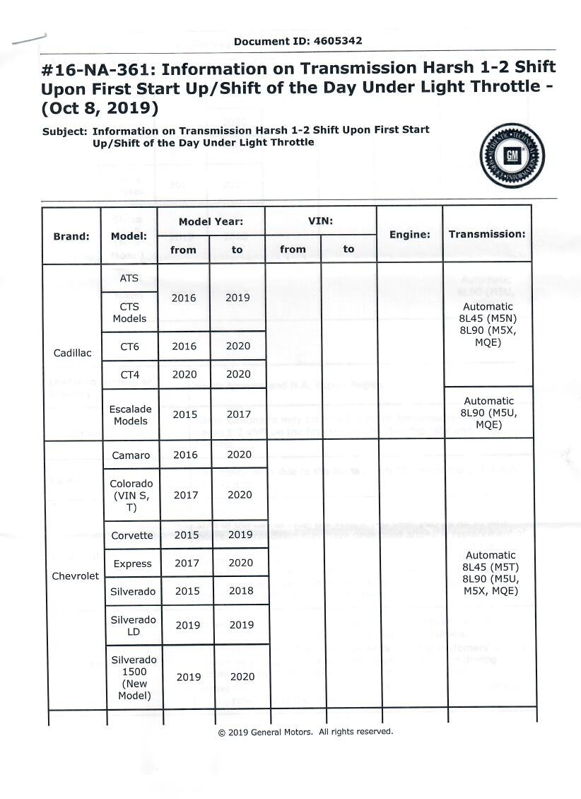

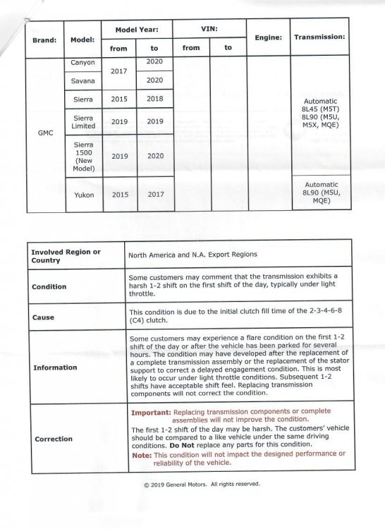

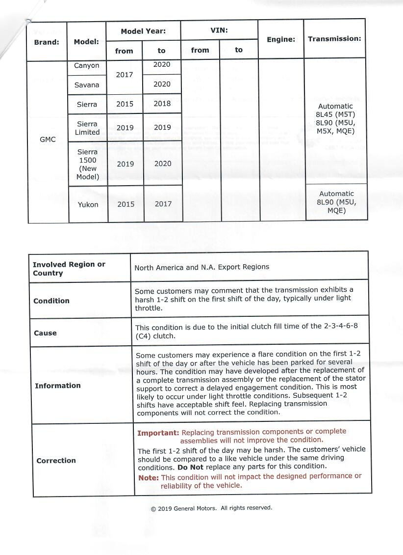

Well it is official now after 5 trips to dealer(s) for a stumbling transmission.  GM has cleaned it's hands of "Stumbling Drunk" syndrome.  Says it is normal.  Not sure what Truck to buy now.  Such BS.  I have owned GM trucks for 35 years.
See attached notice.  Truck
M
Let me get this straight....GM is saying this condition is normal? This document came out on October 8th 2019 right? I would assume by law they have to let you know this before you buy the truck. This is insane.. They didn't let customers know it was normal.
