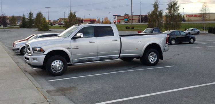

So I ended up going to an '18 Dodge 3500 Limited, it has the H.O. 6.7, Aisin tranny, and self leveling airbags.  Dodge now has an in house designed 30k 5th wheel for the 3500 which beats the F350 AND F450 due to the limits of the 27.5k 5th wheel rating.
