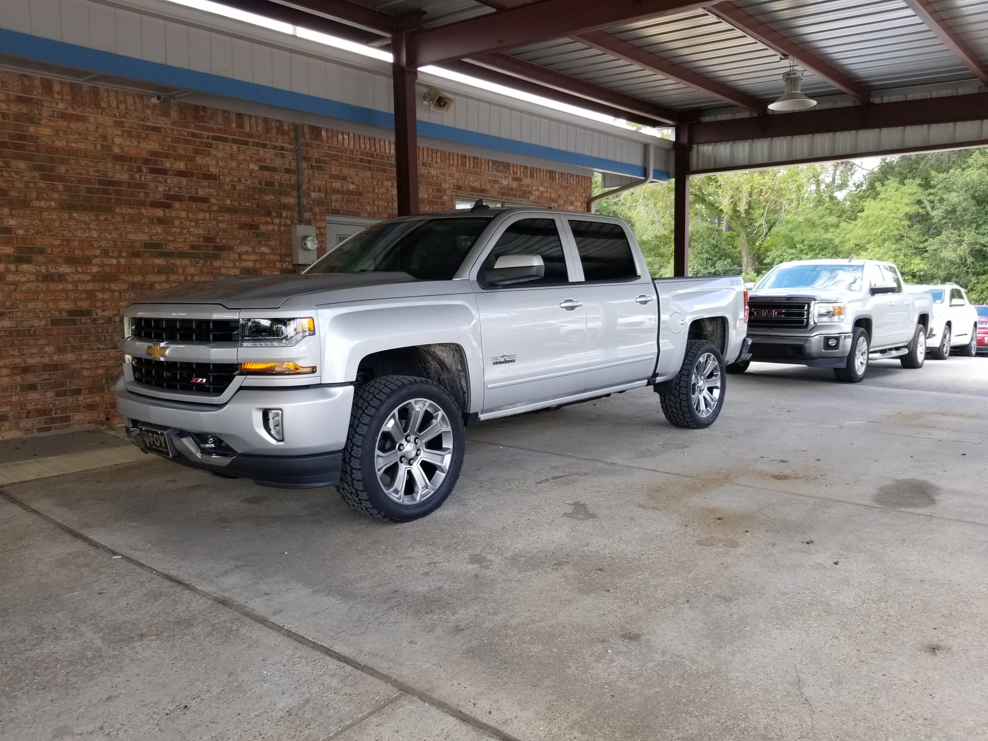

Don't do it. They look great but the vibration is horrible and tires are expensive. I have a 2016 and put a 2.5 rough country level on it. Better going with 18s or 20s. Later on I am doing a 18 and 33 combo, plus it's not too great in the winter either175cea353680a48200a18f0533775e4d.jpg
