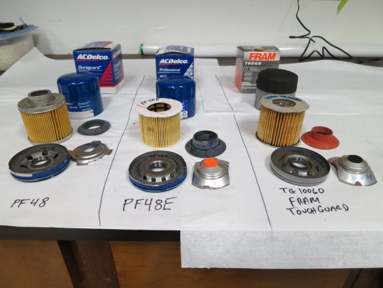

Good afternoon.  On my 07 I had the dreaded low oil pressure issue.  Changed the oil pressure sensor and no help, then read the GM bulletin to install a UPF48R filter.  Unbelievably it cured the problem and low oil pressure was never an issue again.  My question is, can the UPF48R be used on my 2018?  Thanks

The PF63E is what is recommended by GM.  The by-pass valve setting is now at 22psi.  This was increased for a reason.  I would not go with any other filter that doesn't meet the 22psi rating.  The 2007 is a different oil system than the 2014 and up engines.  Even Wix made a change to their application for the new LS engine to reflex the pressure increase.

Here is the service bulletin in regards to the above concern. GM has released an updated PF48R. I recommend using a PF63 as these filters have never been a problem. Not to mention the larger (longer) size makes them much easier to install and remove.

If you are working on a Gen4 V8 that is setting a DTC P0521 and or low oil pressure indicated on the instrument panel in cold or hot weather and the engine is currently equipped with a PF48E oil filter, replace with a UPF48R oil filter if one is available.
Note: Only use the UPF48R oil filter if theGen4 V8 is setting a DTC P0521.
