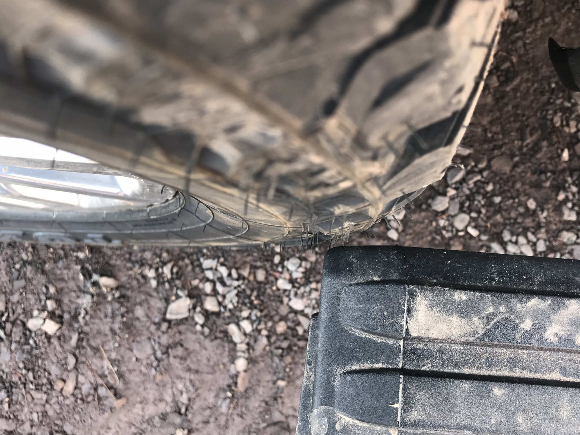

On 12/6/2018 at 9:44 AM, SpennyC22 said:
Just wondering if you lost the step up function of your running boards when you installed the bigger tires? I’ve noticed that the boards get really close to the tire in the third position. I got my Denali about a month ago still deciding weather I want to go 4in or hold out until a quality 6in comes out.82C545F4-5A45-46A2-BB28-9786279FB640.thumb.jpeg.90142bb1a52bfa8a8888fdd0b34222ed.jpeg
Steps are close but don’t touch. About 1/2” of clearance with 33x12.5x22. Anything wider or use of wheel spacer may cause them to hit the tires

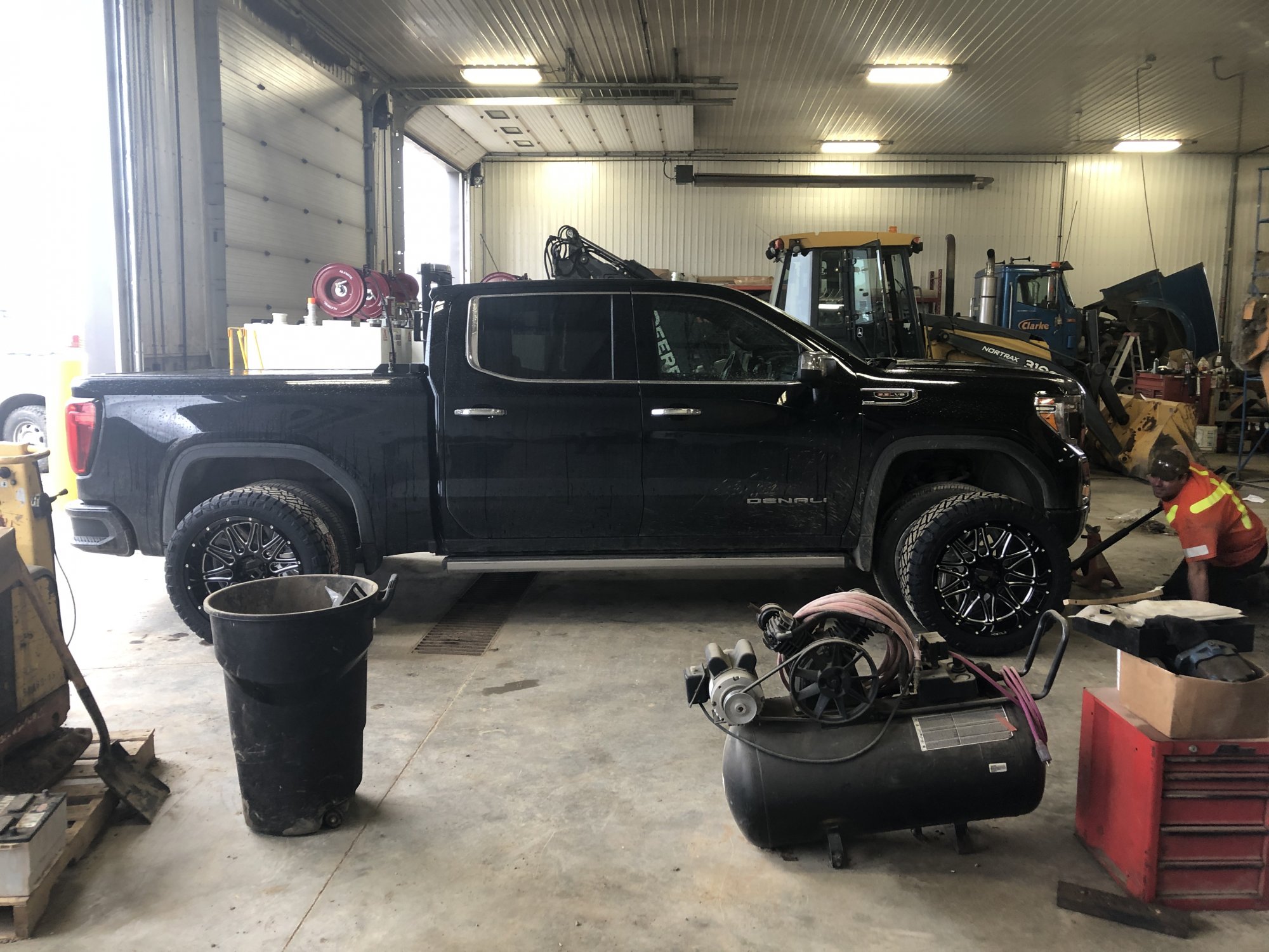

Little update on my truck:
I ended up purchasing a 3.5” lift kit from Fabtech and I also picked up 22x10-25 Hostile Rims wrapped with 33” x 12.5” Ridge Grapplers. The rims however did not fit the new brake calipers are too big so I’m waiting on spacers, only need like 5mm extra room they were really close. I’ll keep you guys updated I think I’m going to lift it tomorrow or Wednesday depending when I get spacers. I have a feeling I’ll have to do a bit of trimming.
Im also doing a flow master muffler and removing the resonator. I did a Borla Attak on my last truck while my brother did this and while the Borla was definitely better the cost justification between the 2 wasn’t in my opinion. I’ll let you guys know after I get some seat time if I end up really regretting it
Also so on the truck is a back rack and bakflip mx4 tonneau.
PS I will clean it for when I post the updated with lift pictures but here’s where I’m at.
