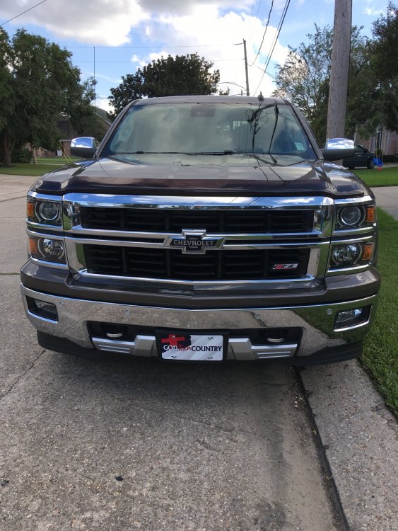

Cheverado Posted October 5, 2018 Posted October 5, 2018 Since they don’t make one to fit the 2014-2015 front grille, I “massaged” a tailgate emblem to fit.
Bobaloo22 Posted October 6, 2018 Posted October 6, 2018 That looks great! I'm intrigued , how hard was it? I may have to copy that, it looks so good
Cheverado Posted October 6, 2018 Author Posted October 6, 2018 2 hours ago, Bobaloo22 said: That looks great! I'm intrigued , how hard was it? I may have to copy that, it looks so good Thanks. It’s a long process so time and LOTS of patience are needed. -start by taking a deep breath because you more than likely paid between $65 and $100 for this emblem. -start by removing the adhesive tape from the back. -using a radial arm saw and a sharp carbide blade, cut a 3/16” deep slot down the back from top to bottom -copy the angle of the bottom of the grill pocket with a contour gauge. -I put mine half way in a wood padded vise and began to SLOWLY and evenly heating the middle area until it bends. This step alone took me at least half an hour. I got about 75% of the bend in this step. -now do the same to the outer portions creating the needed contour. (lots of dry fitting) —you will need to shave about 1/16” off of the sides and round over the points just a bit to get it in. -double stick tape from there?? - andvthe square part of the new bow tie is narrower than the old one so you will have some “gappage” on the sides. I did some strategic filling with silver silicone.

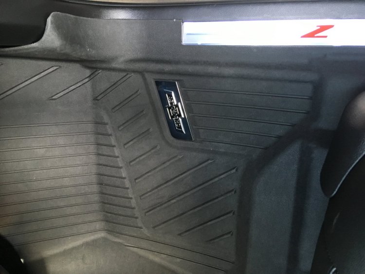

Cheverado Posted October 6, 2018 Author Posted October 6, 2018 34 minutes ago, Red Rally 2 said: I’m a fan of custom, so I love it. Did you put one out back also? And the floor mats
sldhead700 Posted October 7, 2018 Posted October 7, 2018 And the floor mats Love the emblem on the floor mats too!!Sent from my Pixel XL using Tapatalk
Cheverado Posted October 10, 2018 Author Posted October 10, 2018 On 10/5/2018 at 6:08 PM, Cheverado said: Since they don’t make one to fit the 2014-2015 front grille, I “massaged” a tailgate emblem to fit. So I get home today and this is what I see.they got the bow tie and the license plate with the bracket?
Raven Z71 Posted October 10, 2018 Posted October 10, 2018 1 hour ago, Cheverado said: So I get home today and this is what I see.they got the bow tie and the license plate with the bracket? Unbelievable, I hate thieves. Karma will eventually catch up to them. Put a claim in and get yourself an illuminated bow tie, or replace it with the centennial. Then again the centennial may get stolen again. ?
RACERX7775 Posted October 10, 2018 Posted October 10, 2018 They better hope you don't see it on another truck. Since its a custom made piece, it won't be hard to prove they stole it.
Cheverado Posted October 10, 2018 Author Posted October 10, 2018 12 minutes ago, Z71RED said: Unbelievable, I hate thieves. Karma will eventually catch up to them. Put a claim in and get yourself an illuminated bow tie, or replace it with the centennial. Then again the centennial may get stolen again. ? Correct, I just put the old one back. In fact I put the gold bow tie back on the tail gate as well
Cheverado Posted October 10, 2018 Author Posted October 10, 2018 2 minutes ago, RACERX7775 said: They better hope you don't see it on another truck. Since its a custom made piece, it won't be hard to prove they stole it. That’s what I was thinking
RACERX7775 Posted October 10, 2018 Posted October 10, 2018 God help them if it was my truck and i saw them with my stolen pieces.
