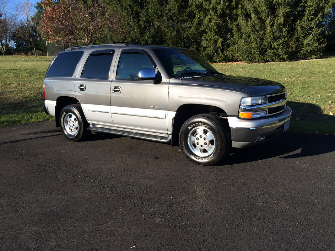

In hindsight I wasted money replacing the calipers without correcting the problem, but now I know that everything is new in the front, ready for the next 200,000 miles. The money I spent was still less than half of a new car payment. The old Tahoe is in pretty good shape for 18 yrs old.
