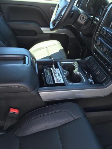

You will have to swap your center console upper tray to the ones on the picture.
Recently swapped my middle seat for floor center console in my 14 RCSB.
Btw these are the cheapest that I’ve found. Cup holders go for 100+ and tray goes for around the same.
Here are some pics. I also did this myself as I wanted removable cup holders and the ability to add another set.
GM changed the upper tray design 14/15 have the upper tray with the slits. 16+ upper trays don’t. The cup holder design itself is also different.
2016+ console/upper tray:
2014/2015 console/upper tray
Side by side comparison
This is the rubber pad insert that “closes” the gap between the different trays.
Final build.
Hope this helps.

I had a 15 previous to my 14 and it had the cubby but right now I can see 2 screws/nuts. Im wondering if it had a liner..[emoji848]
Which I think it did...
I’ll pull the non removable cupholder out when I get home. But when removed, it’s the same access as the 14/15 units. Just not easily accessed.
Here is a 16+ tray.

Thats the reason why I swapped mine., the little cubby underneath the removable cup holder is perfect to hide goodies.. [emoji41]
