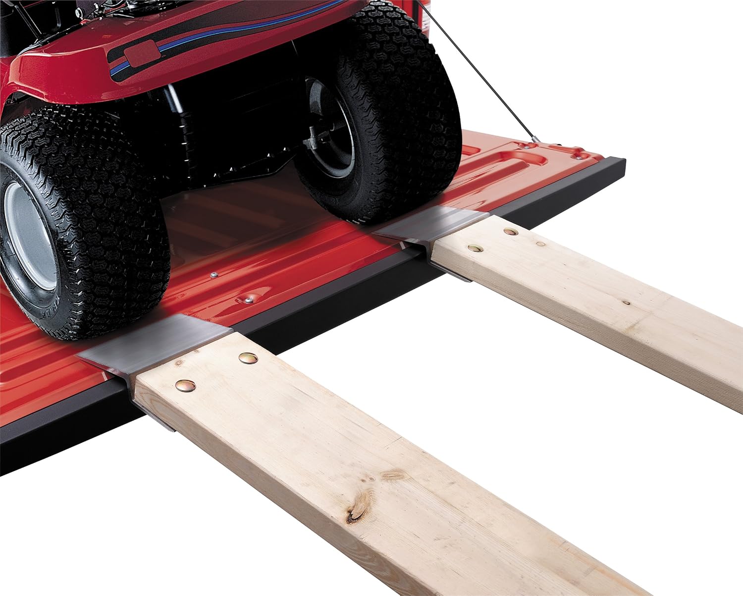

Probably not what you are looking for, but I just made my own from some brackets, carriage bolts, tie down rings (for the safety straps), and lumber.
I wanted to load a concrete lawn roller into my truck for one job, and did not want to buy an expensive set of ramps.  That was two years ago, and I have not used them again since, so I'm glad I did not spend much cash.

I also second the lumber ramps. cheap, easy to cut to whatever length you want. the only problem is that they don't fit in the short box very well if you want to transport them. I cut mine to fit inside my old truck's 8' bed :(
i would find something that attaches securely to the tailgate. Ive seen far to many people have the ramps slide out from under whatever they are loading. Its funny for me to watch but not so funny for the person it happens too.

One should always use straps to secure the ramps from sliding off the tailgate!
Example:
I attached this type of attachement to the underside of my diy lumber ramps for attaching the straps.
straps are probably the safest method to secure ramps. But when I was removing snow in town, I would drive the old snowbolower up my ramps into the truck between jobs. Everything was covered with snow. But I bought some thin rubber sheets with adhesive backing and put that on the bottom side of the tabs that sit on the tailgate. A quick "brush-off" of the snow with my glove and the rubber did not slip at all. It worked very well. But that was only me risking a snowblower. If I had a $1000+ machine that I was loading, I'd take more time to secure everything.
I've used the same ramps to load a dirtbike and snowmobile with no issues. For the snowmobile I attached some of the hard plastic slides to the top for the skis to ride in. For the center ramp, I stapled some rubber "tread" so the track didn't spin. You can't beat the versatility of wood to make it fit your specific situation.
