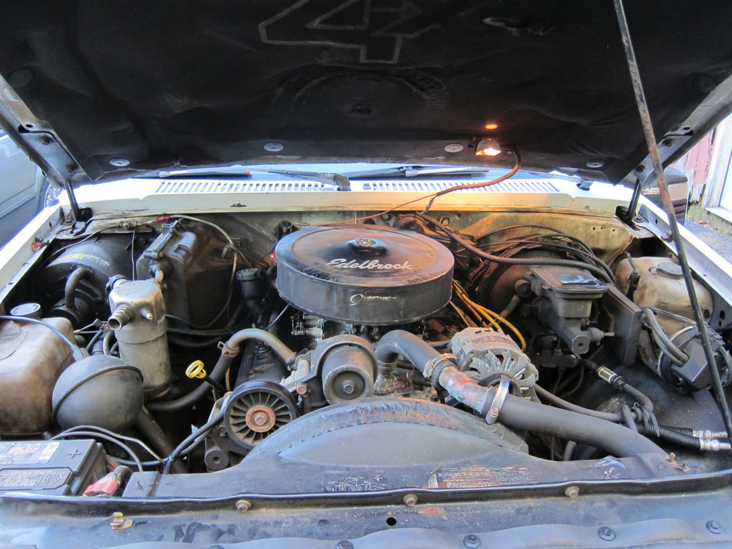

Not that I'm aware of. I've done FI to carburetor on a '00 4.3 before, and swapped the whole intake manifold with an Edelbrock performer. Really easy.
Used ones are harder to find for the 4.3, but you might get lucky. I paid $300 about 7 years ago for the intake, and another $300 for the carb. I made that all back selling the spider, both intakes, EGR and other emission crap, and the fuel pump off the '00.
TBI is even easier, but you'll still have to reduce the pump pressure a bit with a regulator. Or, you could just run a Walbro reciprocating pump inline, and leave the pump in the tank - there's one model that's got a 10k hour salt spray rating, and has a built-in regulator. Was a no brainer for me, since a Holley regulator was $90 at the time.

Your cheapest way out would be a very heavy iron marine intake manifold. Luckily, the marine industry used the 4.3 heavily.
I remember when after market TBI first appeared. People were switching their carburetors to TBI. We did my nephews Trans Am. It ran smoothly no wasted gas, better mileage, more power. Hit the key it started, no flooding pumping the gas pedal. I can’t imagine why anyone would want to go backwards.
I prefer being able to manually adjust, or repair the carb - no such luck when a magic box goes up in smoke. :)
My latest TBI is going on 9 years without needing an adjustment. I never got that out of a carburetor. Usually carburetor vehicles engine would need service from mishaps caused from the fact it had a carburetor and no engine management.
I had an Edelbrock 1404 carb on a '00 4.3 in a '89 S10 Blazer - 8 years, 60k miles, never touched it - slapped it on right out of the box.
