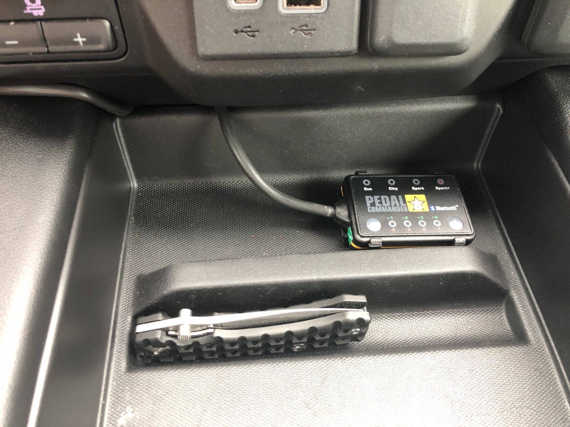

So i put that money towards a pedal commander and I am very happy with it.   It doesn't add any power, just changes the responsiveness of the throttle, but it sure feels like it has another 100 HP.   Sport mode is jumpy enough around town that the whole family noticed... they asked why i was driving so aggressively :)
As interesting as the instant response to pushing the throttle... is that it downshifts when you give it a bit more gas... where without the commander the same amount of throttle would have kept it in the same gear and lugged.
Very noticeable upgrade vs just having the speedometer accurate :)
