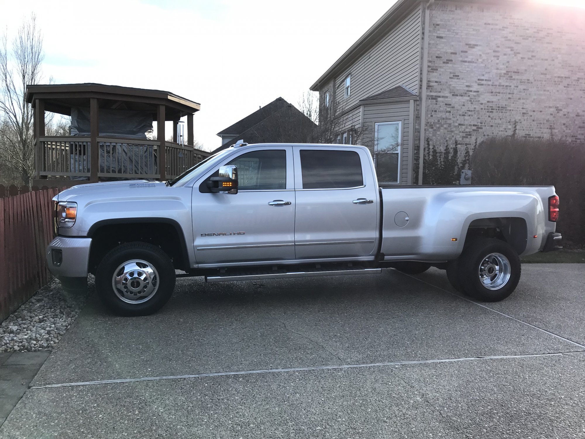

Just bought a 2019 3500HD DRW from a dealer 300 miles away. On the way home, a slight vibration can be felt and gets increasingly worse. Vibrates through the seats and through the steering wheel. 40mph it’s not really noticeable.  60mph is annoying. 75-80mph the mirrors and hood start to shake.
Once home, I lowered tire pressure from 70/65 down to 60/55. This seemed to have helped as now the hood doesn’t shake at higher speeds. Tires are Michelin Primacy XC.
Have an appointment set with local dealer. I’m waiting another week so odomoter has over 500 on it.
I’m anxiously optimistic that it just needs a road force balance or maybe a new tire. Truck was sitting for 2-3months. Had 40 miles on it when purchased.
Anyone have anything similar happen with theirs?  Did a simple thorough road force balance do the trick?
