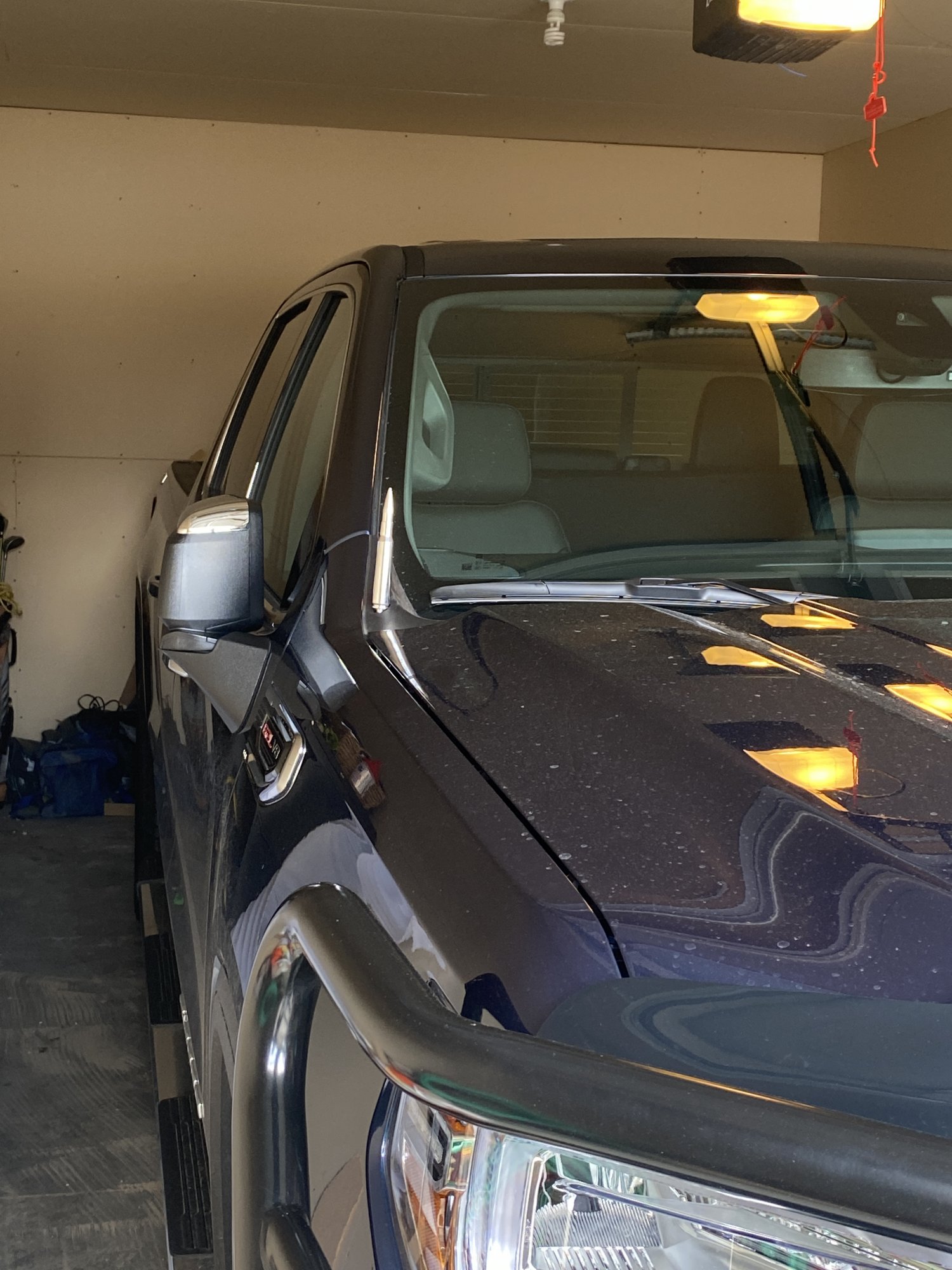

I had the same problem with my antenna hitting the garage door.  I removed the ball on the end, shortened the antenna and reattached the ball.  I used a Dremel to shape the end and refit the ball.  A quick spray of paint and the antenna was ready to go.  Easy fix.
