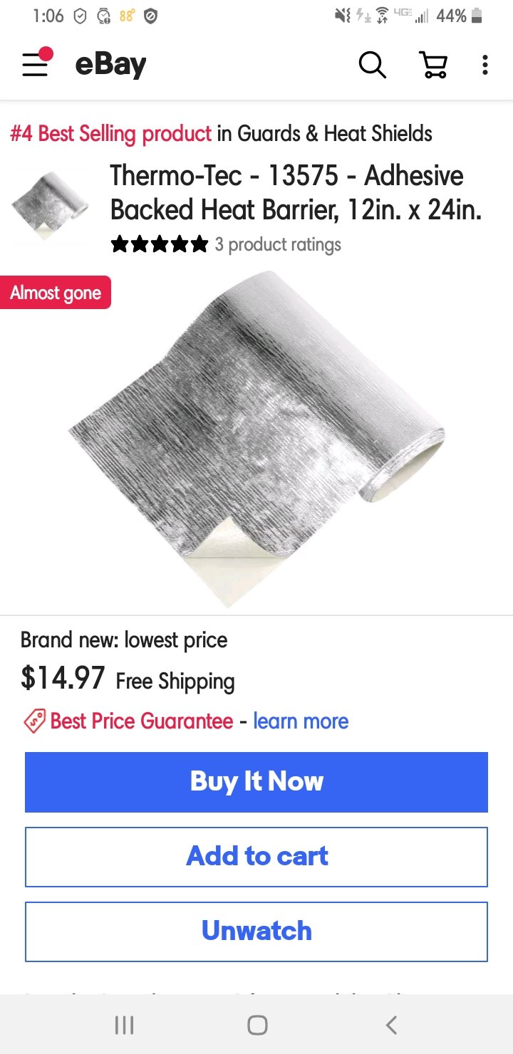

What I did is to purchase a Borla Model 40359 muffler,  ditched the flapper and left the resonators.  If you cover all six resonators it gets pretty loud and has some drone under load.  I hit pay dirt using 1 and 1/2 resonators covered on each side.
To cover them I used:  Thermo Tec 13575 12" x 24" Adhesive Backed Heat Barrier Thermal Pad Mat Tape NEW purchased on fleabay.  It can be cut to size and wrapped around them.  No slippage.
