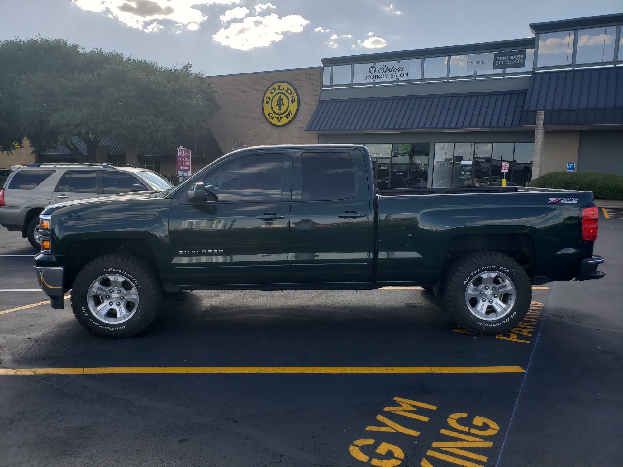

DustinZ71 Posted April 12, 2019 Posted April 12, 2019 Hey all, I am looking to do the exhaust on my 2015 z71 and am wondering what the difference is in the performance and sound between true dual system and a single in dual out muffler? Im mainly looking to improve the sound, so trying to see if there is a discernible difference. Appreciate your thoughts and comments!
