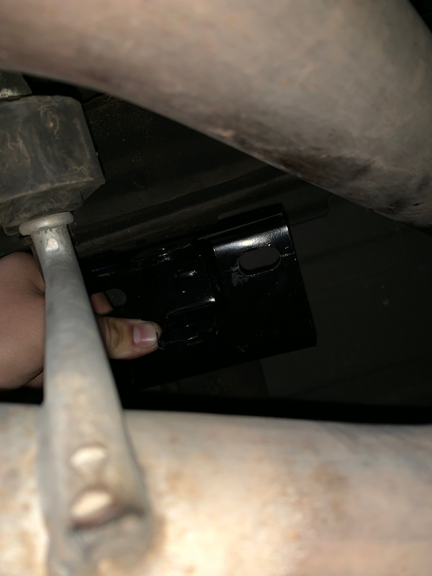

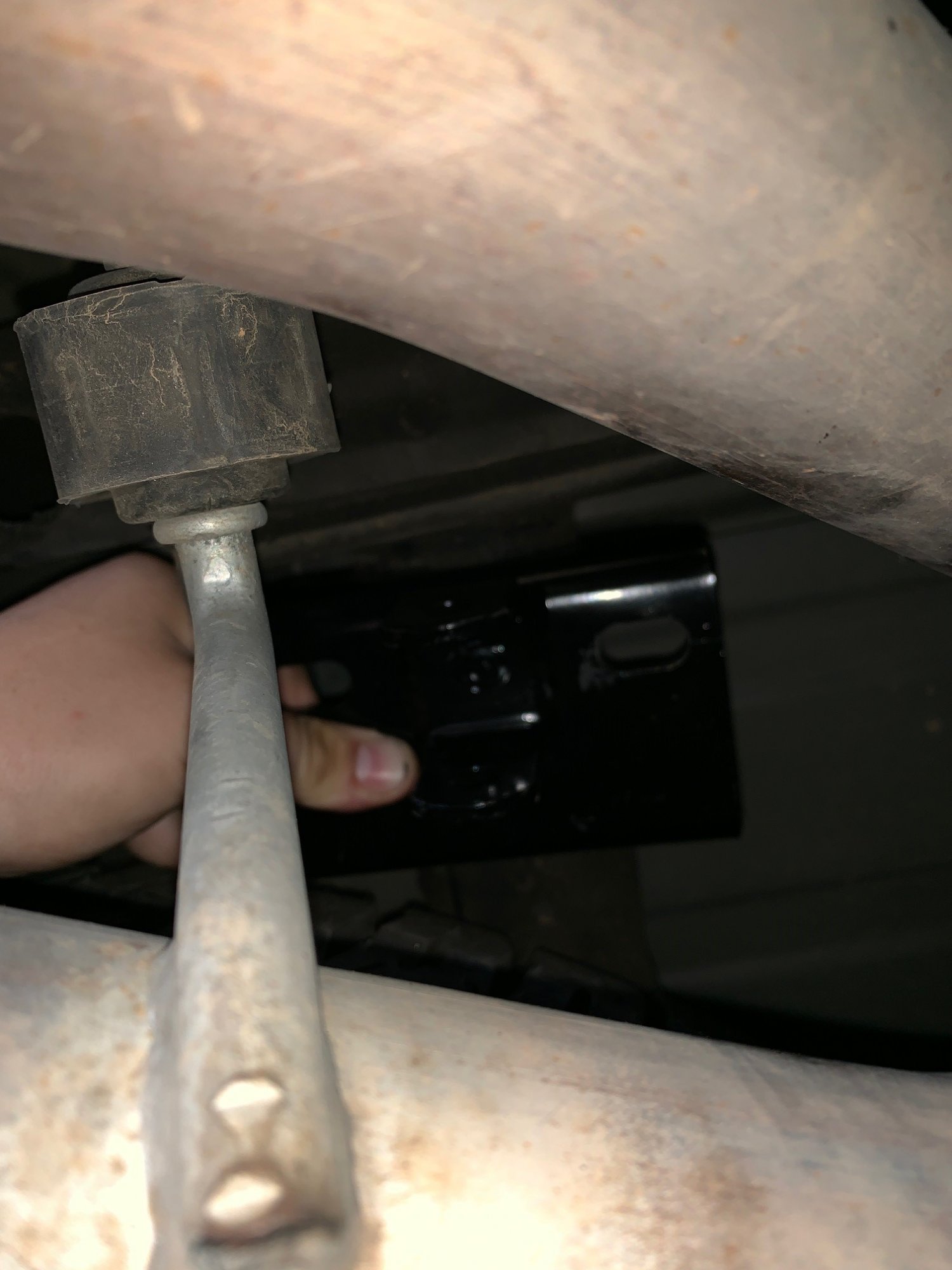

Just got my hellwig 7735 bar in and very frustrated to know that it will NOT work with a Gibson Dual Sport, or any dual side exit exhaust (close to the OEM location).
NO WHERE is it listed on their website not fitting, and once I emailed in, never got any support on it.
Waste of $400...

do you have pics on what is hitting?
the End link bolts onto the frame rail tube, and looks like it would go between the 2 pipes.  Hellwig gives you some spacers and the endlink attaches to the outside of the swaybar.  I would recommend you at least bolt the end links up and have a look.
The endlinks hit straight in the middle of the pipe. Already tried with no luck

Youre telling me. I wanted this so bad, but I am not giving up my exhaust for a sway bar.
