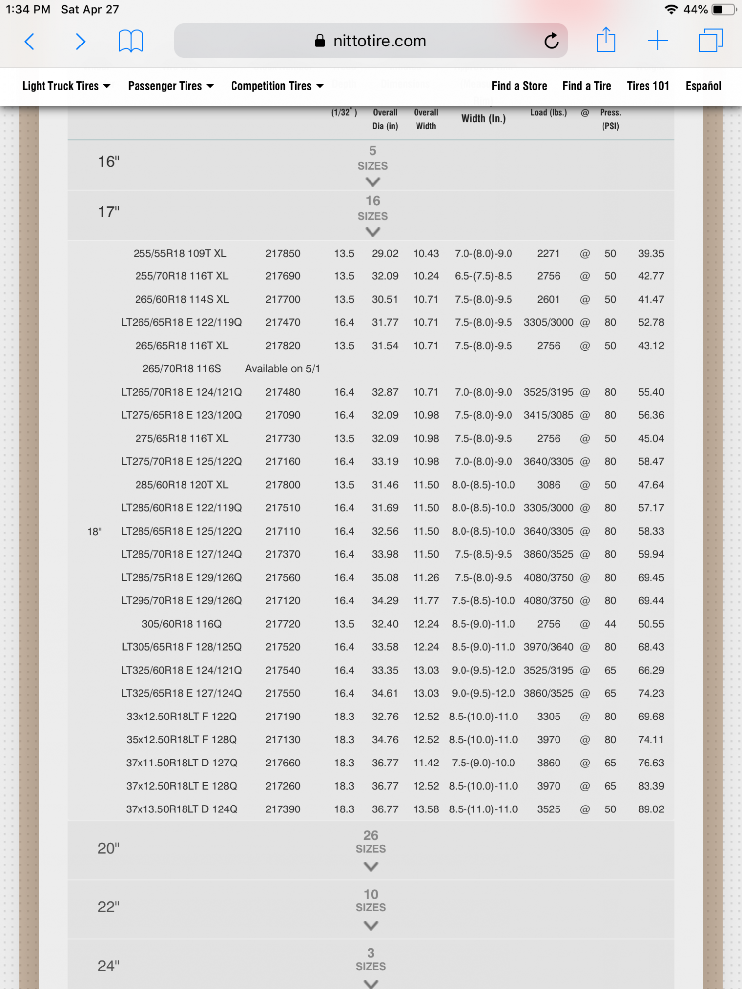

i own a 2016 crew cab 4x4 5.3 and its time for new tires. I don’t do much hauling and off-roading but when it comes to using it would be great if I had a good setup.
Doing some tire shopping/research after finally deciding on the tires I want I came to realize that the nitto ridge grappler 305/60r18 doesn’t have a “LT” rating and has a 116 load index while almost all others have lt and a 120+ ratings...
I really wanted these tires since these seem to be the biggest I can go and hopefully no rubbing but I’m back to being undecided because of this.
if anyone could give me some advice from their opinion/experience with tires and ratings on what I should do would be truelly appreciated!
They are Standard Load tires, same as factory tires.  They do not increase weight rating, so not the best tire if you do much towing
