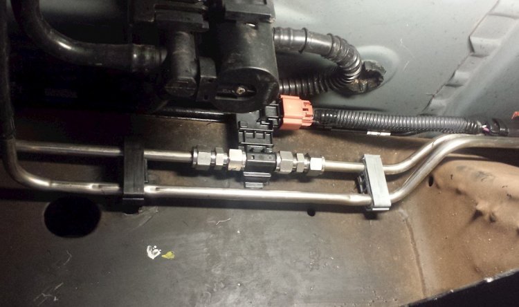

I not sure what the exact location of the sensor on a stock flex fuel truck.  But you could crawl under there and look for the sensor.  The is on the inside of the drivers side frame rail just before the fuel tank.  Right were the trans cross member comes across.  The picture I attached is of a after market set up for trucks but you should have the same sensor plugged in somewhere closer to there.  Because even if it's not flex fuel the same wires are there with the plug just attached to a dummy plug that is clipped to the frame.   Mine isn't flex but the wires where attached to the frame were the main frame rail and trans cross member have a corner plat welded to them.  If your not flex fuel it's only 60 bucks to add it then go back to your tuner and have him enable the tables in the tune.  He should charge for that since you already paid him for a tune.  If you had HP tuner I could show up how easy it is to turn on.
