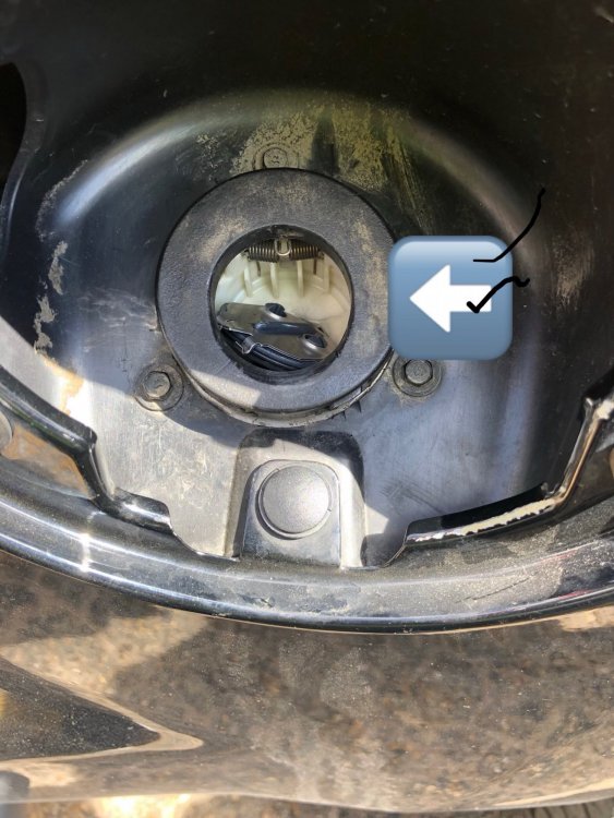

HELP! I just bought my 17 Silverado and went to get gas, when I did the spring door on the capless fuel broke off. Does anyone know how to remove the plastic shroud that surrounds it? Seems like it would pry off, but its not budging..... thanks in advance
That shroud won't come off. You have to replace the entire neck.
Should be covered under warranty, unless you are over 36K.
Thank you! Will be taking her in

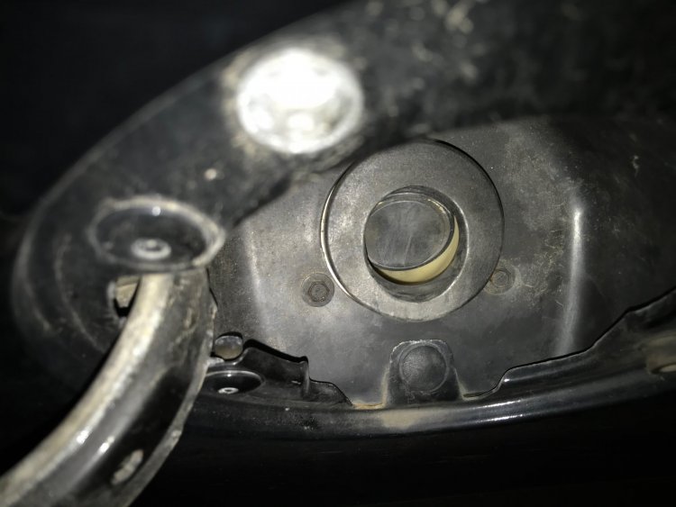

Mine too.   $350 to replace the neck.   If it breaks again, it'll get a rubber cap.
If it happens to my 2017 truck out of warranty I will be replacing my filler neck with the 2014-2015 style neck with the cap.?
The picture that was posted is worth a million words...IMO I never fully liked our truck's  capless design.
I don't like seeing dirt and water collecting near the fill inlet. I would rather have the old gas cap type unless GM re-designs their
capless neck to seal better or have a better sealing gas door system.
They won't because of cost, so thats why I'll go backwards with the screw on gas cap neck at some point.
