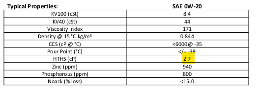

These GF-6A oils are the polar opposite of this:
Red Line HP 5W20
Valvoline 0W20 GF-6A
This second oil is 2.7 for a hot second and a 8.4 at 100 C until stressed. The SSI is awful.
GF-6B oils...:bs:
And again, you can't SAY at thing true.
