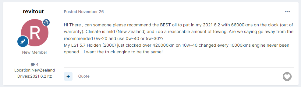

Anyone remember, "Four out of five Doctors recommend KOOL Menthol for sore throats". :crackup:Experts promoting an agenda. Who's paying who to say what.
Know what I trust? My lying eyes. My instrumentation. Post OP teardown inspections on MY equipment I do over 50 years of driving and building. SAE tech papers. Peer reviewed published Doctoral papers. And my 40 years in the business. I also trust rational conclusions based on the foundations laid by those whose shoulders we stand on. I trust the laws of thermodynamics, gravity, entropy and so on and so forth.
I've run oils between SAE20 and SAE60 and every commercial multigrade in between. I have never seen nor measured an increase in oil temperature that was based on viscosity that any reasonable person could extrapolate, interpolate or measure directly or indirectly as 'viscosity driven wear' inside the bounds of a 'well tuned' and flaw free motor, retail products operating in the real work a day world.
I have seen bulk oil temperatures move with changes in base oil type. I have seen temperatures get out of bounds when there is too little viscosity and I have seen mechanical issues push an oil to resemble ciders. But the idea that running a 5W40 in a well tuned road motor who's manufacture is specifying a 0W20 will wear it out is a....
LIE
What do you think the median oil VISCOSITY is for a motor run by the "Little Ole Lady" whose total trip length is under 10 miles between cold starts and lives in Edmonton. Think it may be different than say Death Valley and 100 mile trips? You see more variation is the daily operation than in five weight grades at operating temperatures and the OEM does not change his recommendations for Jack and Jill Average. But he will call out 0W20 for a 6.2 Truck and 5W30 for a Corvette and *W40 for track days. Ford Mustangs LOL 5W50.
Fella I referenced in the last post is about to double the 'Expected and Legal Life Time" of that LS motor running 10W40 in New Zealand. Look that latitude up. 43 degrees. Closer to it's pole than I am to mine.
