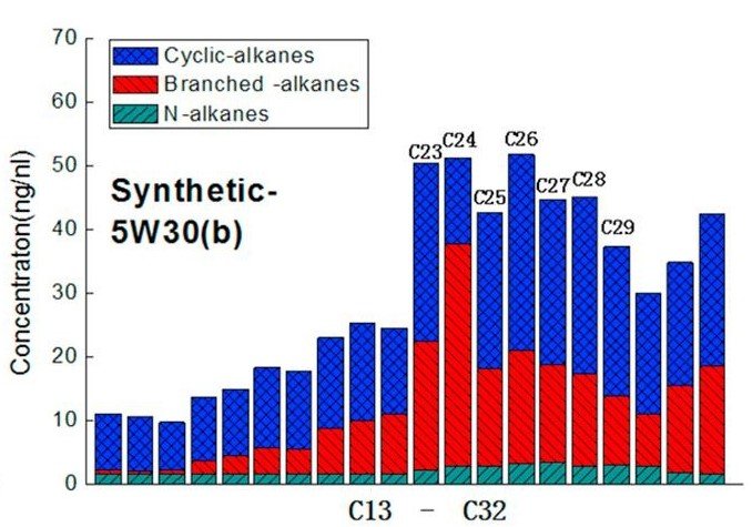

A chromatogram in bar chart from to show more detail in makeup.
Before processing the red parts of the bar were a greater portion of each chains length. Straight chain alkanes reformed and saturated into cyclic-alkanes and other straight chain alkanes into isoparaffins (branched alkanes). A small amount of normal alkanes remain. Saturated is more stable than unsaturated and isoparaffin more stable than cyclic structure (Oxidation resistance)  Chain length is limited to prevent waxing which improves pour point.
Okay here's where this is going....That chromatogram will be different in composition from every oil field and from every blend of fields. It will even vary from the same field over time thus so will it's performance.
