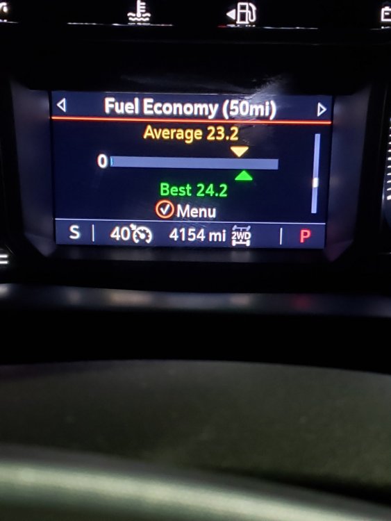

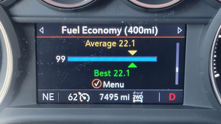

I'm aware of that.. I'm assuming it's like 60 psi on a 35 psi tire. My tire says 35psi and I'm reading from others it's fine to do 40 psi as well. Temperature is consistent around here so I don't worry about heat causing it to swell. Do they put 35 psi on the tire expecting it to hit 40 during the hot summer months so it's actually 40 but they don't want to get too technical?

well i keep the front at 40 to start with, so driving makes it pump up to about 45psi, i leave the rears at 33-35, they aren't really doing the hard work like the front tires
Just my personal experience with the K2** (running all season standard load rating not all terrain or E type). Under 35 psi (cold) mileage drops pretty quick. Above 35 psi there is a slight difference but not one I've been willing to trade for ride/wear/tear. And I mean wear/tear on the rest of the truck not the tires. Shock....
