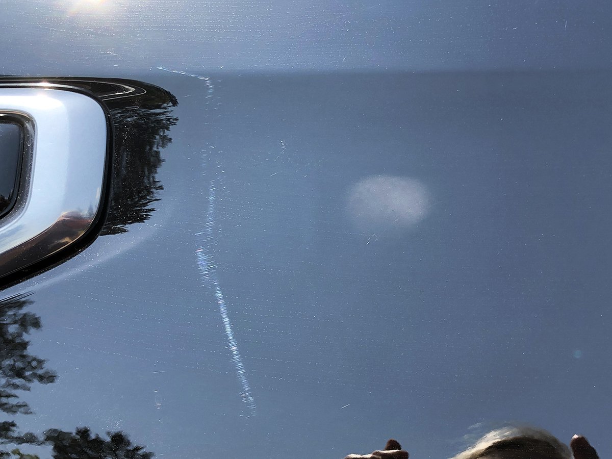

So, I just bought my top of the line Sierra AT4 Friday afternoon. Yesterday, when I was washing it, I noticed it has several half-dollar size paint flaws. I'm pretty certain when it was being painted, a particle got into the basecoat which is probably then inspected for flaws and any found are wet sanded by a human before final clearcoat. Who (or what) ever sanded these areas was pretty ham-fisted and it looks like they sanded right down to the primer, which was then cleared. So, the final product is a nice shiny half-dollar sized primer spot. Fairly disappointing for a $70K truck.
There are 2 spots on the passenger fender, one on the passenger door, one on the driver's door and a fairly large area on the top of the front bumper which looks like the paint fisheyed and was wet sanded then cleared over, resulting in a primer spot with black spots. There may be others but these are the ones I've noticed so far.

You're in the hands of Service at this point.  I would not wait for the Salesperson at all.  It looks like someone tried to repair a couple individual spots and didn't finish the job.  The hazy spots look like they didn't buff out the clear properly after wet sanding or they went through the clear (which is thin to begin with) trying to fix the spot and the ring is what you're left with.  I don't think it's clear over primer from the factory.

I can't see any blend, difference in sheen or even an air pressure variation anywhere around the areas which is why I believe they tried to feather the nibs & went through the paint and cleared the whole mess. Either way, it shouldn't be there. My warranty book says they'll take care of any "flaws" that were missed at the factory, so I'm really hoping they make good on it. I absolutely love the truck otherwise.

If those flaws were just in the clear and not base coat that body shop is making a killing.lol
Edit...just seen the last pic. The first two look easy, but that last one is debatable.
That would be true! They're definitely in the base though.
I REALLY wish it was just clear.

I doubt they will furnish a new truck for a couple paint defects.  I feel your pain though because if they have to "paint" they will need to spray base on repair and then blend clear on the whole panel.  Depending on where the marks are, they may have to blend into adjacent panels to get it to look right.  Then you have the issue of factory texture (orange peel) matching repair texture so it doesn't stand out.  The body shop is really key.  As mentioned earlier, I would probably get a 2nd private opinion from an elite body shop in your area.  You may even get GM to allow you to go to your shop of choice with them funding the project.
Years ago I bought a new Chevy pickup and didn't realize the bed rail had been re-sprayed (somewhere between the factory and the dealer) because it was raining when my order came in and I took delivery.  The following weekend, I noticed a hard (obvious to the touch) paint line where the bed rail meets the rest of the quarter panel.  I was not happy, but all they would do is look to improve the repair.  They did allow me to go to a body shop of my choice however.  In the end, I didn't need repaint, only wet sanding and buffing to improve and blend the area.  It became something only I was aware of but I had a bad taste for a while.
I asked the body shop if they plan on doing a spot repair or what their procedure is. He says they will not spot it, they will repaint each panel. I hope they can simply panel paint and don't have to blend to the adjacent panels since that is really where you can see the orange peel difference and black can really be a devil because it plays tricks on your eyes depending on the lighting.
I did stress the importance of achieving a match to the factory orange peel and he says they will. I, however, have my doubts. My father was a body man and owned his shop for 50 years and I did paint & body off & on for about 25. That makes me one of two things; a PITA or an informed customer (which is still looked at as a PITA. lol!).
