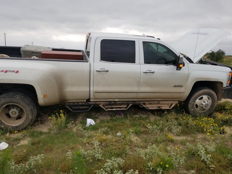

My 2017 high country 3500 dually....purchased 6 weeks prior to this..42,000miles completely stock...decided to dig its own grave and almost mine!! traveling at approx. 75 mph on a texas state highway (2 lane) my L5P out of no where started what most call diesel runaway. the truck out of no where accelerated on its own, to complete red line rpms and speeds of 90 plus...I cant recall what the top speed reached was but for about 2 miles I had both feet mashed on the brakes to no avail.  massive amounts of smoke blew behind me mostly white.  the truck held steady pushing through the brakes until I heard it blow and lock up and I coasted to a stop over a mile after that....this whole time I had to maintain the left lane avoiding hitting other vehecles in the rear and thank god no one came in that lane.  after stopping there was a fire under the truck but it went out fairly quick...I have ideas of what happened under the hood from reading forums but any insight would be appreciated.  I could not slow it at all until it blew...softball size hole in pass. side of engine. scariest situation ive ever been in...currently awaiting call from the dealer!!

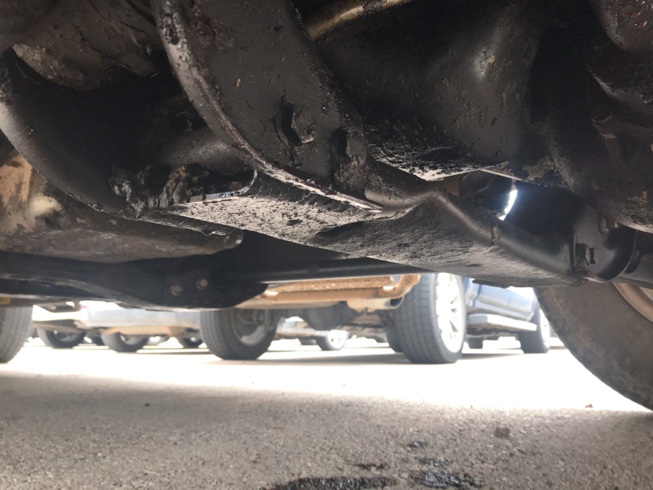

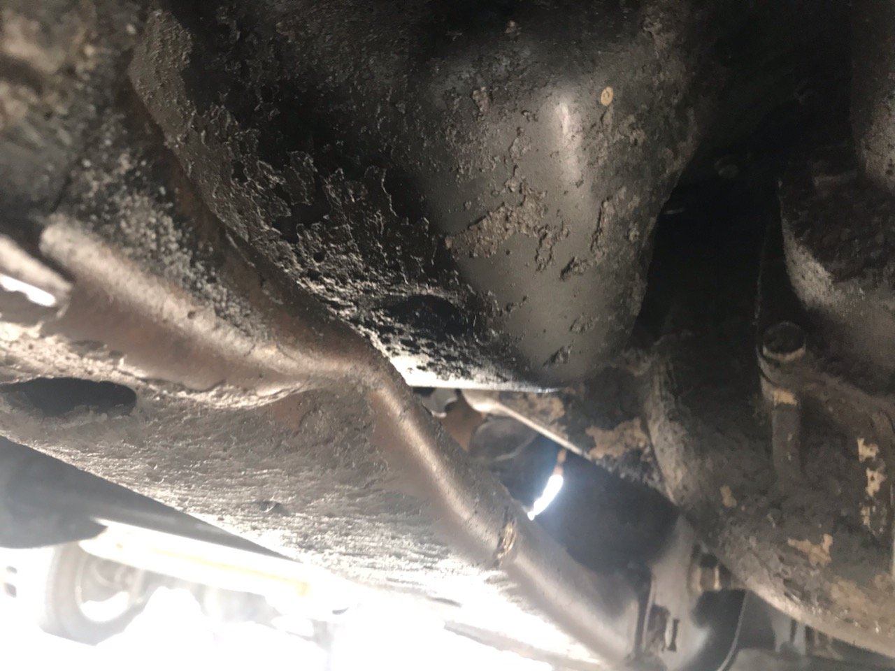

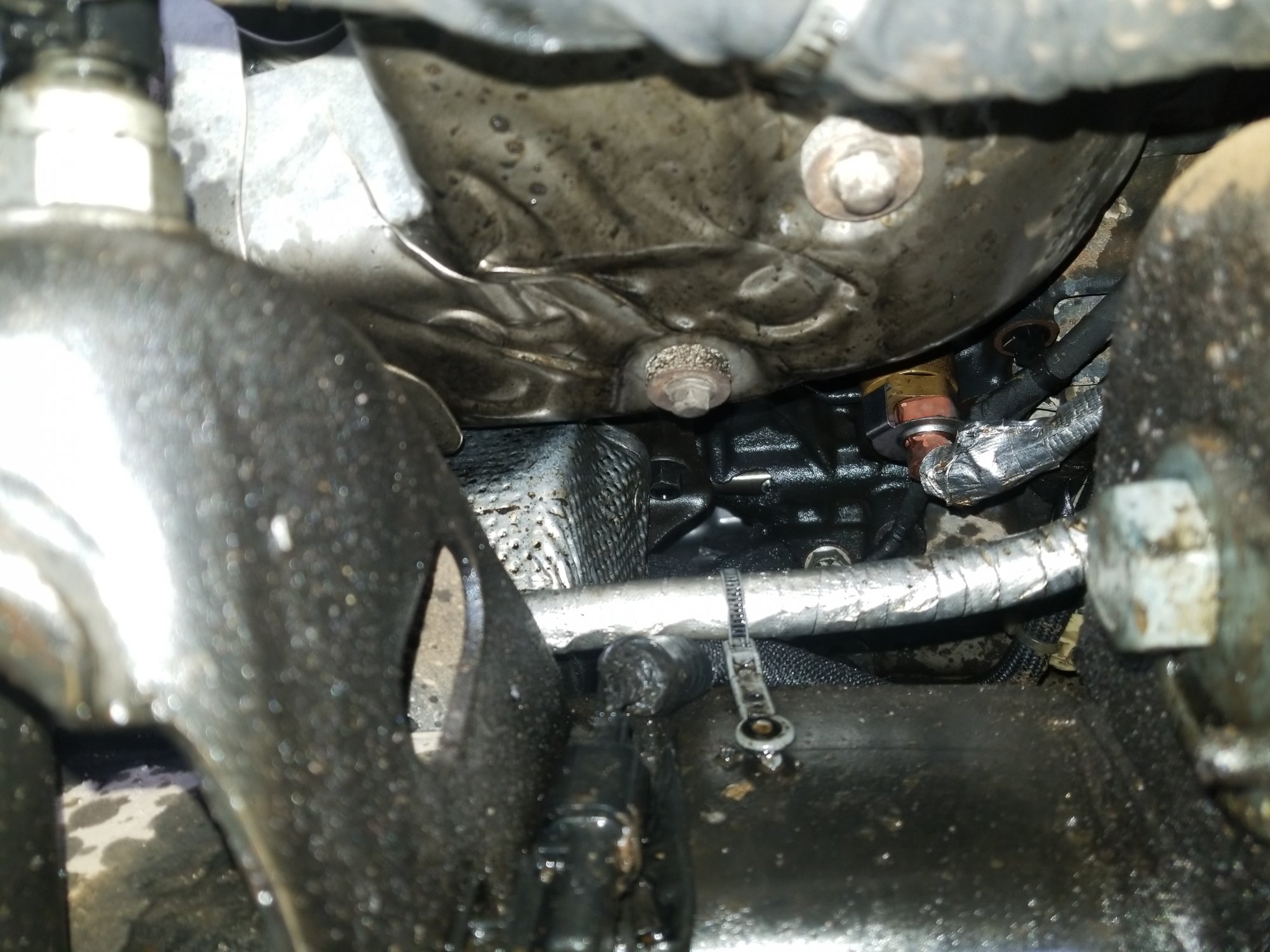

Sorry for the long delay in getting back to this I've had a little extra stress. The truck is still at the dealership and gm is denying any help with it. They claim there was damage to the oil pan  and it has a hole in it. For starters how would that cause a runaway....2. I did not hit anything to cause any damage. 3.i went to the shop Monday and looked for myself and there is no "hole" in the pan....there is a small ding in the pan and a significant dent in the crossmember which had to have happened prior to me buying it and I over looked it. I bought it at 34k miles. That means I had put 8k on the truck with a whole in the pan (and an oil change lol) get real people. We all know a couple scenarios that may have caused this and they have no answers for me. My insurance has stepped in because of the fire and "might" cover the damage but still fighting with chevy....(only $24,800 as estimated by dealer).....they have not even dug in to see what's inside or what happened even though their telling me they did. Lies on top of lies. This gets more frustrating and more ridiculous by the day....i filed a complaint with GM and GM has contacted them and they are supposed to come up with some answers. I have posted pics of the hole in the engine and the damage under the truck. I will keep you posted.
Also not sure how oil coming from pan at 80mph could be all over the truck....(much less cause a runaway)...by far the worst and most frustrating experience of my life. And to answer the questions I was a little more concerned with the traffic around me than to think how to kill it.  I was in the left lane at 80mph and climbing(2 lane highway) and trucks beside me but now I know the things I  would have tried wouldn't have worked. Also it may not have been 2 miles but it sure seemed like a long time when I couldn't control it. The dealership is just trying to get out this costing GM. It wouldn't be hard to find the cause of this.  They just see an easy out.
