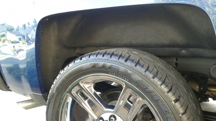

After much research I went with Falken Ziex 305/40r22's since they were the same height as stock on 22x9" wheels with a +27 offset.  Good wet/dry traction and noise is not much worse than the original Bridgestones. I only had a slight left side rub on the inner wheel house liner on a full lock left turn while hitting a bump with stock front height and 3.25" lowered rear. Not sure how much difference there would be with a 45 series 305 but I can tell you that when I hit a pothole I know I hit a pothole although I have never damaged a wheel.
