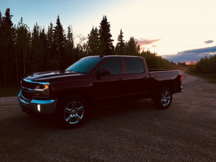

Got a side pic of the truck?....interested to see how it looks.....those the Bilestein adjustable shocks in the front to level it out?
Yes, at top notch which I think is just about 2 inches eb01581579acda969181437a6ec2455e.jpg7b0a4812b0189bbad00b709e4687cc07.jpg0f6babd5b747fe803a7f5027bd488c1a.jpg
You should be able to run max 275/60/20 without leveling. Leveled 2016-2018) will require new wheels with different offset but my neighbor is running that size stock. Leveling will make it worse cause of your stamped steel uca’s. I’d have the tire store like discount tire test it after install to make sure you’ve got no issues. Good luck
