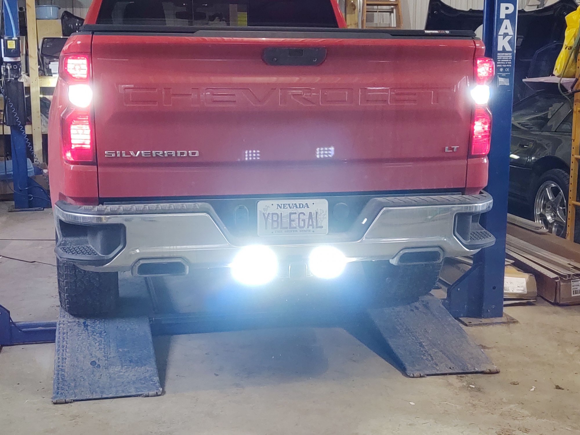

Reverse on my truck is green with white tracer being a Z85 trailering package. Unfortunately this was not a good power source for auxiliary lighting because the truck has to sense(electrically) a trailer in tow to work. Next step I tied into the blue positive / black negative on the cargo lamps. This would allow the aux lights to flash 3 times then shut off all cargo lamps. My little project is much harder on this new truck then the last ones I have had.
Did you find a fix for the tap off the cargo lights?  I just did the same thing and got the same result.  I'm hoping there's a fix because i really don't want to redo all of it. When I connected the first light,  it worked with no issue.  Then the second light caused the triple flash and off.
Lights are shutting off due to overload.  Run a relay (4 pin relay) to your trigger source and grab a constant 12v to power the relay. Ground the relay and wire the lights to the relay.  Most are using the 12v from the 7 pin trailer plug, use a volt meter to determine it.
Got it.  Thanks for the info!
