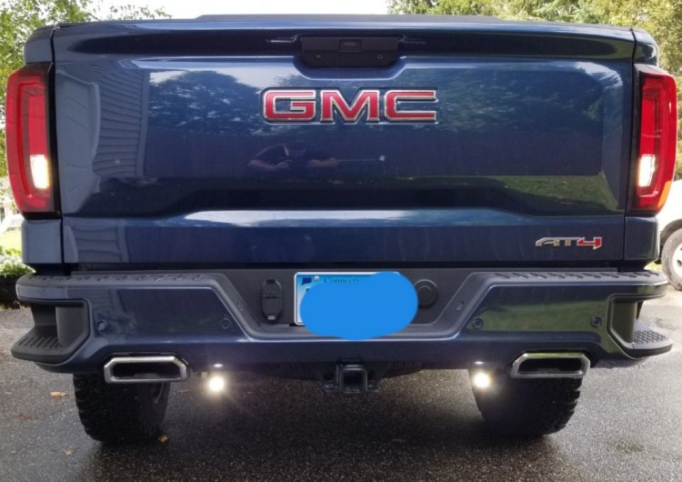

That sucks.  They look nice.  Clean install.  So, to flush mount, you’d cut holes in the bumper?
Yes
On 7/3/2019 at 4:30 PM, NHAT4 said:
If you are wiring in additional reverse lamps , pull the talilamp assembly and tie into the reverse feed there.  Thats what I did. No issues.

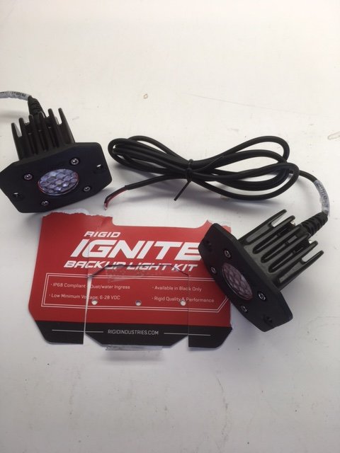

I'm not sure if this will work for the T1, but a clean look is mounting Rigid Ignite Back-Up Lights in the rear bumper step. I did this on my 2016. If they don't fit inside the step, maybe they'll fit on the flat plastic that is more flush with the bumper. They do require a couple inches of clearance behind them...
I installed mine about three years ago and have had no issues. They are each connected separately to the factory back-up light wiring directly above...
They put out a tremendous amount of light for their small size. I believe someone asked if they will light up across a 20' driveway (I know the thread is old), and yes they will...and then some. They will light up my 70' driveway and still illuminate trees and fences on the other side of the street. All this without washing out the backup camera...

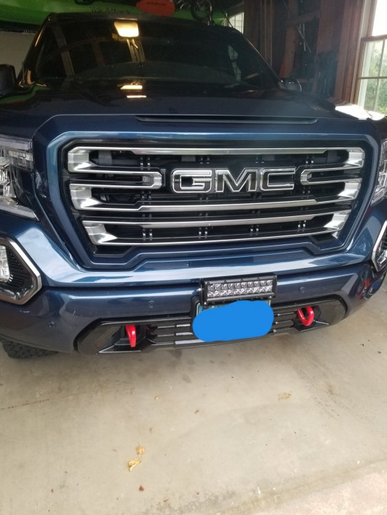

How is the light bar mounted - bumper or License Bracket ???  Both lights look good.
